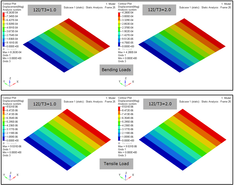

- The bending stiffness parameter
(12I/T3) can be defined as the ratio of the bending moment of inertia
of the shell (I) and the bending moment of inertia of a homogeneous shell
(T3/12). This parameter influences only the bending stiffness of the
shell element (for example, the displacement results due to bending and tensile loads are
presented below). The bending stiffness increases with increasing value of
12I/T3. This parameter can be used to represent non-homogeneous
material (such as honeycomb, concrete, and so on).
Figure 4.
