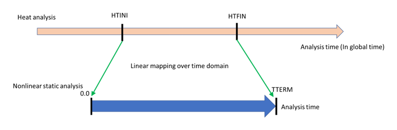

- The temperature field defined in
HFILE/HSUB is a linear mapping from
the time domain in between HTINI and
HTFIN to the Nonlinear Static Analysis or Nonlinear
Transient Analysis time domain.

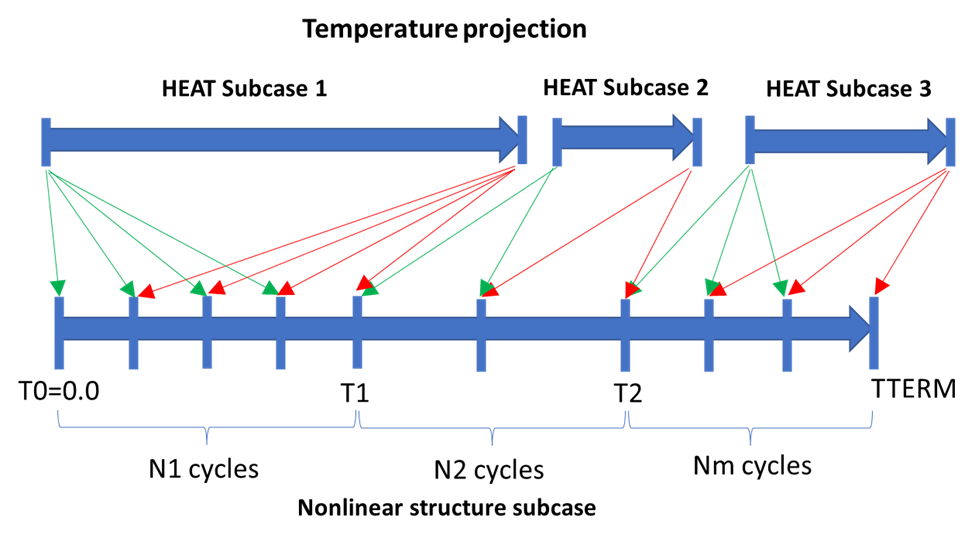

- REPEAT can be used with HST=HFILE, HSUB, or MHSUB. When used with HST=HFILE or HSUB, the thermal loading from the HFILE or HSUB is applied N times as the value defined in the following field until the end of the nonlinear structural subcase.
- The temperature projection for
HST=MHSUB
is shown below, in which T1 and T2 are the TEND values.
N1, N2, and N3 are the REPEAT values. The thermal loading
from each heat subcase is compactly applied in the time domain of the
