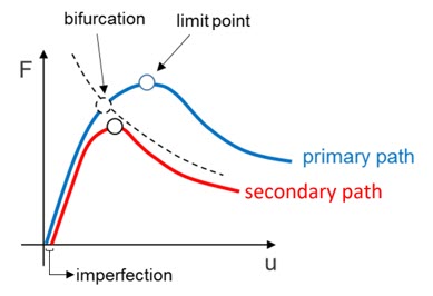

Imperfection is used in large displacement nonlinear static analysis, for example, to solve post-buckling problems combined with the arc-length method, among other techniques.
Usage
Geometric imperfection can be applied to stability sensitive structures which have difficulties in being solved, because of local or global buckling.

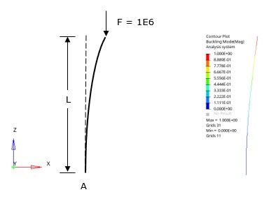

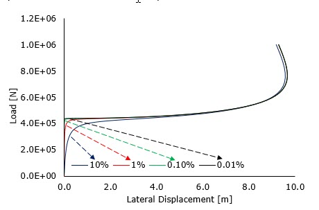

Example 1: Post-buckling of Euler Column
The post-buckling behavior of a classical Euler column subjected to a vertical loading of 106 N at the top, is investigated to show the imperfection with different scaling factors.

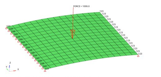

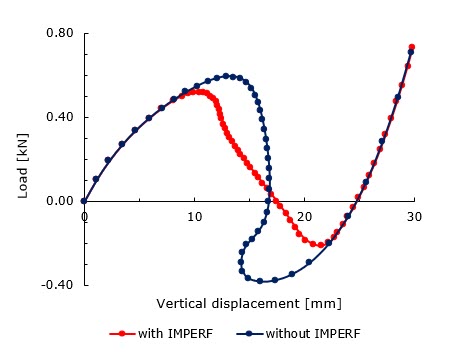

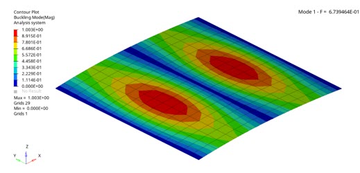

Example 2: Post-buckling of a Cylindrical Roof with a Single Point Force
