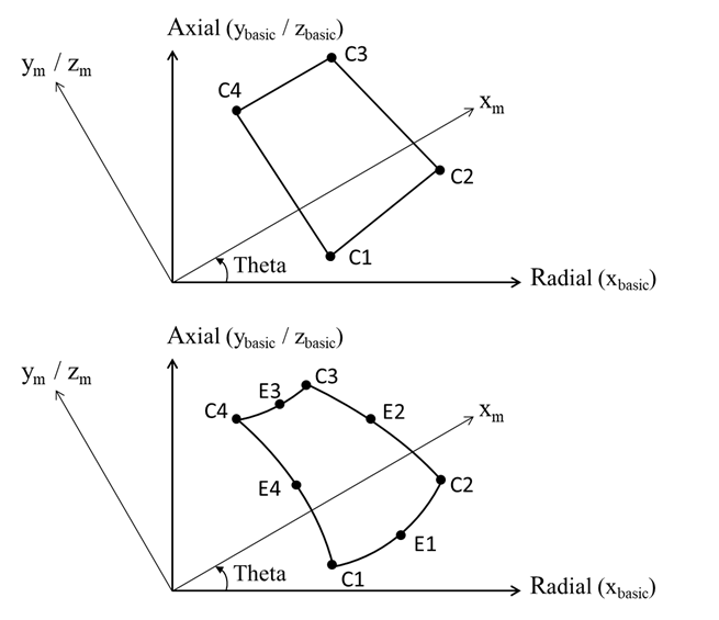

- The element grids numbering scheme is
controlled by
SYSSETTING,AXEGORD,0/1.
SYSSETTING,AXEGORD Corner Grid Points Edge Grid Points C C C C E E E E 0 (default) G1 G3 G5 G7 G2 G4 G6 G8 1 G1 G2 G3 G4 G5 G6 G7 G8 - All the grid points must be in the x-y plane or in the x-z plane of the
basic coordinate system with x = r ≥ 0.
Corner grid points C, C, C and C must be present. The edge points E, E, E and E are optional. If any of the edge points are present, they all must be used.
Note that this information is consistent only for the default SYSSETTING,AXEGORD,0. If this is switched to 1, then the corresponding grid point references should be interpreted accordingly.
Figure 1. CQAXI Definition
- The continuation line is optional.
- If the PAXI entry referenced in field 3 references a MAT3 entry, material properties and stresses are always given in the (xm, ym) or (xm, zm) coordinate system shown in Figure 1.
