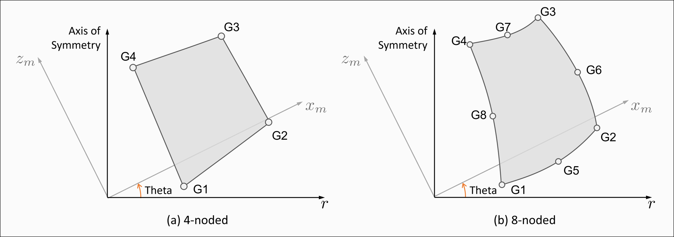

| G1, G2, G3, G4 | Identification numbers of
corner grid points. No default (Integers > 0, all unique) |
| G5, G6, G7, G8 | Identification numbers to
edge grid points. No default (Integers > 0 or blank) |
| Theta | Material orientation angle in
degrees. Default = 0.0 (Real) |

- The grid ordering of
G1 through G8 is defined as shown in
Figure 1. All grids and the axis-of-symmetry must be on the same
plane, and the grids cannot span across the axis-of-symmetry on this plane.
Figure 1. CQAXIG Definition
- If the PAXIG entry referenced in field 3 references a MAT3 entry, material properties and stresses are always given in the xm-zm coordinate system.
