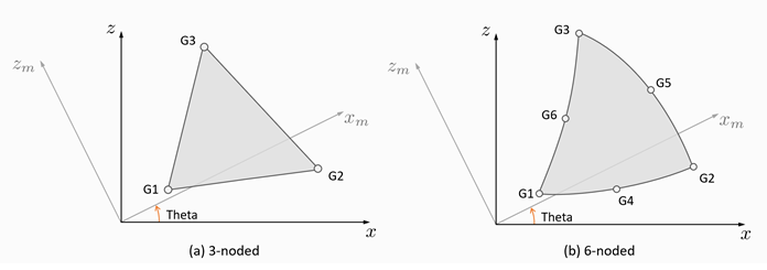

- The Grid ordering of
G1 through G6 are defined as:
Figure 1. CTPSTN Definition

- If the PPLANE entry referenced in field 3 references a MAT3 entry, material properties and stresses are always given in the xm-zm coordinate system shown in Figure 1.
- Plane strain analysis defined in x-y plane is supported, that is, the axis labels of “z” above can be replaced by “y”.
