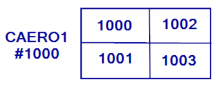

- The entries of DMI must be a column vector of size equal the number of aeroelastic boxes across all boxes in a CAERO1 Bulk Data Entry.
- When multiple CAERO1 Bulk Data Entries are present, then the box number set of each CAERO1 is arranged in ascending order of the CAERO1 IDs.
- For example, consider CAERO1 #1000 and CAERO1 # 2000 which have four and six boxes respectively and a DMI Bulk Data Entry defining initial downwash matrix (W2GJ).
Then the values from the DMI Bulk Data Entry are applied as follows on the boxes.CAERO1 ID Box ID Initial Downwash 1000 1000 0.10 1001 0.20 1002 0.0 1003 0.40 2000 2000 0.30 2001 0.35 2002 0.50 2003 0.40 2004 0.60 2005 0.31 - If the aeroelastic model contains slender bodies

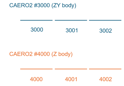

(CAERO2), the values corresponding to the bodies in
the DMI vector must be put behind those for the panels.
- The size of the column vector corresponding to the bodies is equal to the number of Z bodies and/or Y bodies plus two times the number of ZY bodies.
- When multiple CAERO2 entries are present, the element number set of each CAERO2 is arranged in ascending order of the CAERO2 IDs.
- Following the example of Figure 1 and Figure 2, assume that there are two additional bodies with one of them
being a ZY body (CAERO2 #3000) and the other
being a Z body (CAERO2 #4000).
Figure 3.
Then the complete set of values from the DMI entry are applied as follows:CAERO1 ID Box ID Initial Downwash 1000 1000 0.10 1001 0.20 1002 0.0 1003 0.40 2000 2000 0.30 2001 0.35 2002 0.50 2003 0.40 2004 0.60 2005 0.31 3000 3000(Y) 0.11 3000(Z) 0.12 3001(Y) 0.13 3001(Z) 0.21 3002(Y) 0.22 3002(Z) 0.23 4000 4000(Z) 0.31 4001(Z) 0.32 4002(Z) 0.33 - Only non-zero terms need be entered.
