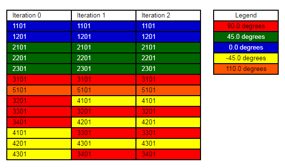

- The RANGE
constraint considers the stacking sequence besides the starting and ending ply
ID numbers. These ply ID numbers are purely used to identify the starting and
ending ply IDs in the laminate, between which the plies are to be shuffled. They
are not a numerical range of ply IDs. If any ply, which is not supposed to be
shuffled, is located in the middle of the shuffling plies, multiple
RANGE constraints are required.In the following example, to exclude ply# 5101 from the shuffling process, two RANGE constraints are specified.
DSHUFFLE 1 STACK 1 + RANGE 1101 3101 + RANGE 3201 4301Figure 4.
