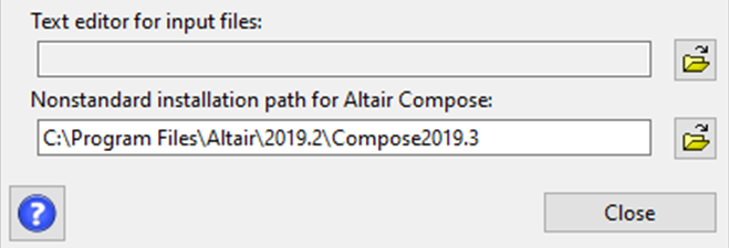

If Altair Compose needs to be invoked during the OptiStruct job in case of external responses (DRESP3), the installation path for Compose must to be specified by the user.
There are 2 methods to specify the installation path from the Compute Console
(ACC).
- Options field
