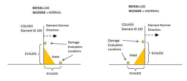

- If specified,
REFEID and WLDSIDE are used together
to identify the direction in which the weld exists. REFEID
identifies an element connected to the weld line, and WLDSIDE
identifies the direction of the weld, with respect to the element normal of the
element identified via REFEID. Figure 1 can help clarify how the weld
location is identified. EVALDIS is the evaluation distance
specified on the PFATSMW entry.
Figure 1. L Fillet Joint Example (WTYPE=L)
