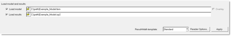

- Vector and Tensor plots of some element force results
(weld, beam/bar and gap elements) are available for post-processing in HyperView only if the .fem file is
loaded in the Load model field and the results file is loaded in the Load
results field (Figure 1 is an example illustration of the HyperView
Load model and results panel).Make sure that the Advanced option is selected from the Result Math template: menu.

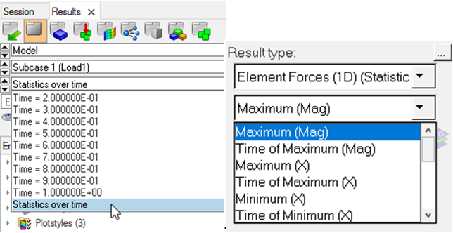

- Element force statistics are
supported for Direct and Modal Linear Transient Analysis.
Only H3D output is supported for element force statistics and the output is available only for the following elements - CBAR, CBEAM, CELAS1, CELAS2, CONROD, CROD, CBUSH, CVISC, CDAMP1, CDAMP2, CGAP, CWELD, CGAPG and CSEAM.
The following statistics over time are output for Transient Analysis when STATIS or OSTATIS is specified.- Statistics
- Supported Element Force Result Types
- Minimum and Time of Minimum
- X-component, Y-component, Z-component
- Maximum and Time of Maximum
- Magnitude, X-component, Y-component, Z-component
- Absolute Maximum and Time of Absolute Maximum
- Arithmetic Mean, Root Mean Square (RMS), Variance, and Standard Deviation
The Element Force statistics can be viewed in HyperView after loading the H3D file, under Statistics over time option at the end of the timestep list in the Results Browser. Then, various statistics can be chosen from the sub-menu under Element Forces (1D) (Statistics) (s).Figure 2.
