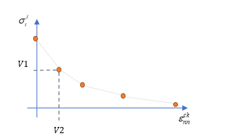

- STRN
- Crack opening is expressed in the form of positive principal stress ( ) versus crack opening strain ( ). The series of values (V1, V2) define a table of ( , ).

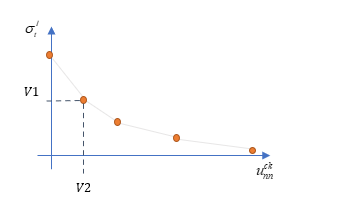

- DISP
- Crack opening is expressed in the form of positive principal stress ( ) versus crack opening displacement ( ). The series of values (V1, V2) define a table of ( , ).

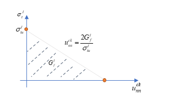

- ENER
- Crack opening is expressed in the form of positive principal stress ( ) and fracture energy ( ). The value of V1 is and V2 is .

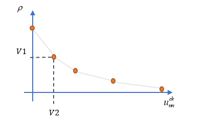

- RFAC
- Crack opening is expressed in the form of retention factor ( ) versus crack opening variable chosen for CRACK OPTION (STRN= , DISP or ENER= ). The series of values (V3, V4) defines a table of ( , ) or ( , ).

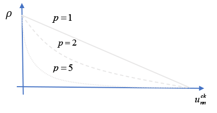

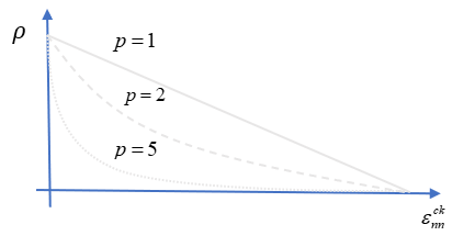

- PLAW
- Retention factor
is expressed in the form of a
power law. This power law evolves following the crack opening
variable chosen in the CRACK definition
(STRN=
, DISP or
ENER=
):or,
