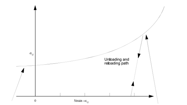

Each stress component must not exceed the permissible values given by the stress versus volumetric strain defined by the curve (LCAA, LCBB, … and so on) for each component.
Thus,The is defined for each component using LCAA, LCBB, LCCC … (see Figure 1). - Compacted Honeycomb Material V < VF

Figure 1. Stress versus Volumetric Strain
