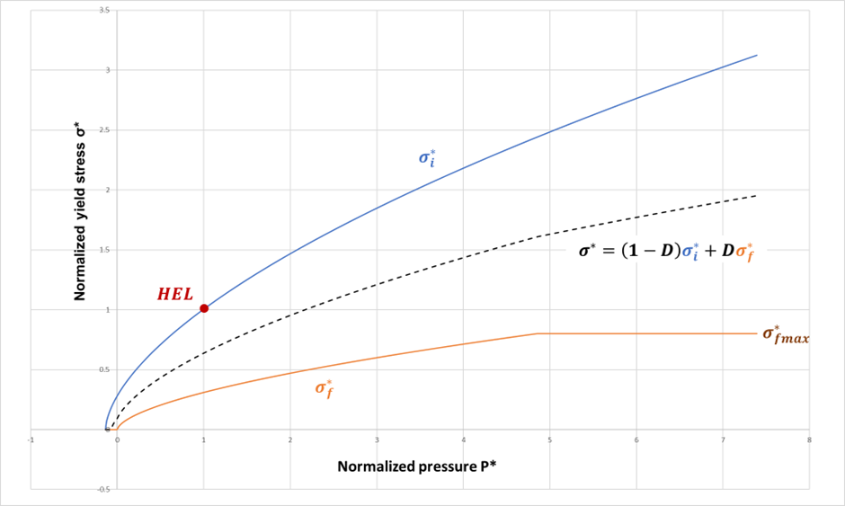

| JHOLMQ | Flag that identifies that the Johnson-Holmquist model parameters are to follow. 18 | |
| A | Intact normalized strength constant.
No default (Real) |
| B | Fractured normalized strength constant.
No default (Real) |
| M | Fractured strength pressure exponent.
No default (Real) |
| N | Intact strength pressure exponent. No default (Real) |
| C | Strain rate coefficient. No default (Real) |
| RSTRT | Reference strain rate. No default (Real) |
[1/s] |
| SMAX | Maximum normalized fractured strength.
No default (Real) |
| T | Maximum pressure tensile strength. No default (Real) |
[Pa] |
| HEL | Hugoniot elastic limit. No default (Real) |
[Pa] |
| PHEL | Pressure at Hugoniot elastic limit. No default (Real) |
[Pa] |
| D1 | Damage constant. No default (Real) |
| D2 | Damage exponent. No default (Real) |
| K1 | Bulk modulus. No default (Real) |
[Pa] |
| K2 | Pressure coefficient. No default (Real) |
[Pa] |
| K3 | Pressure coefficient. No default (Real) |
[Pa] |
| BETA | Bulking pressure coefficient. No default (0.0 < Real <1.0) |

- The Johnson-Holmquist material model is
available to model brittle material behavior. It can be used with MAT1
elastic behavior and is currently only supported for solid elements. The shear modulus (
) and bulk modulus (
) can be used to input the corresponding Young's modulus and Poisson's ratio as:
The equivalent stress is the normalized Von Mises stress:
Where the normalizing stress is the Hugoniot elastic limit is calculated as:The normalized Von Mises stress, is compared to the normalized yield stress obtained with:
Where,- Intact material yield stress:
- Failed material yield stress:
If no damage parameters are specified , no plastic strain evolution is computed and an instant failure is obtained when the element behavior reaches the elastic limit. Otherwise, when damage parameters are mentioned, the plastic strain evolution is computed and the accumulated damage is:
Where the plastic strain to failure is calculated as:
The maximum pressure tensile strength is decreased during damage as:
This allows a smoother transition between and during damage.Figure 2. Evolution of Normalized Yield Stress with Respect to Normalized Pressure. Damage value of D = 0.5.
