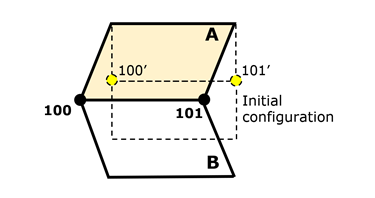

- The difference between using OPT=WOSTRN
and OPT=WISTRN is illustrated below.
Consider example elements A and B, with both the initial and current
configuration, as shown. Element A is inactive in the preceding subcase
and is reactivated in the current subcase.
Figure 1. Reactivated element (A) with OPT=WORSTRN/WISTRN
- Element A
- Reactivated in the current subcase while inactive in the preceding subcase.
- Element B
- Active in both the current and preceding subcases.
- Grids 100 and 101
- Grids shared by elements A and B.
- Locations of grids at the start of the current subcase.
- Initial locations of grids.
- For element reactivation with
OPT=WOSTRN:
- Element A will be use as the zero-stress reference configuration after it is reactivated. So, element A does not take any initial strain when it is reactivated.
OPT=WISTRN:
- As the locations of grids are at the start of the current subcase, element A may take an initial strain when it is reactivated. This initial strain is not immediately but gradually applied to element A in this subcase.
