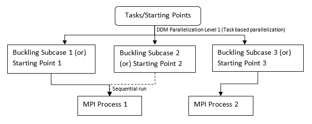

DDM Level 1 – Task-based parallelization
-np=4) which are divided into 3 groups. This is an example of how grouping can be accomplished to parallelize a
model with multiple parallelizable tasks in DDM Level 1

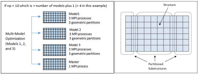

| Multi-Model Optimization | √ Models listed in the main file are parallelized depending
on the number of specified -np overall and/or
the number of -np defined for each model in the
main file. |
√ Task-based parallelization is not applicable within each MMO model. Only Geometric partitioning (DDM level 2) is conducted for each individual model in MMO. |

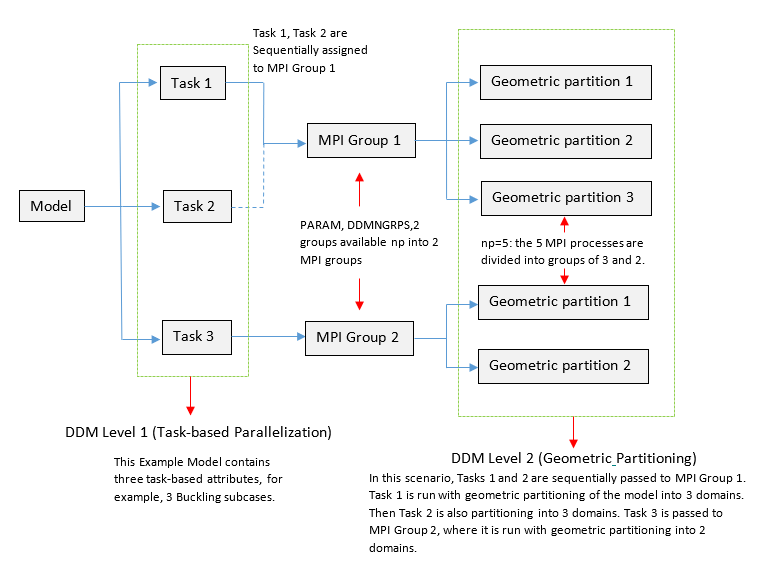

DDM Level 2 – Parallelization of Geometric Partitions
The second level of parallelization occurs at the distributed task level. Each distributed task can be further parallelized via Geometric partitioning of the model. These geometric partitions are generated and assigned depending on the number of MPI groups and the number of MPI processes in each group.
The second level DDM process utilizes graph partition algorithms to automatically partition the geometric structure into multiple domains (equal to the number of MPI processes in the corresponding group). During FEA analysis/optimization, an individual domain/MPI process only processes its domain related calculations. Such procedures include element matrix assembly, linear solution, stress calculations, sensitivity calculations, and so on.
-np=5) . The model has 3 task attributes (Example, 3 buckling subcases, or 3
DFREQ loading frequencies, etc). PARAM,
DDMNGRPS,2 is defined
-np=6). The MMO setup has 2 models. PARAM,DDMNGRPS should not
be used in conjunction with MMO
The DDM functionality for level two parallelization is direct geometric partitioning of a model based on the number of MPI processes available in the MPI group that is assigned to this task.
DDM level 2 is purely geometric partitioning and you can enforce only level 2 DDM by setting PARAM,DDMNGRPS,MIN. This minimizes the number of groups that can be assigned for the specified model, thereby leading to a pure geometric partitioning parallelization.

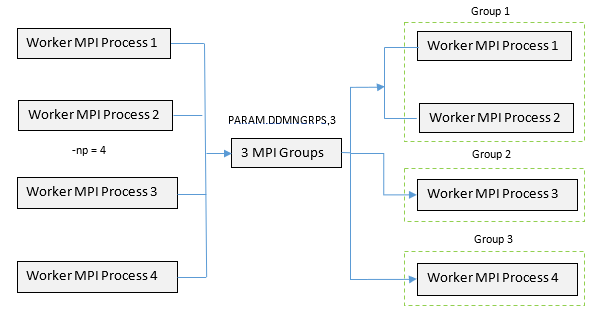

Hybrid DDM parallelization using both Level 1 and Level 2 parallelization is possible
by setting
PARAM,DDMNGRPS,AUTO or
PARAM,DDMNGRPS,#, where
# is the number of MPI groups. In case of
AUTO, which is also the default for any DDM run, OptiStruct heuristically assigns the number of MPI groups for
a particular model, depending on model attributes and specified
-np.
-np and the number of MPI groups.
PARAM,DDMNGRPS,<ngrps>
is an optional parameter and AUTO is always the default for any DDM
run. The model is first divided into parallelizable tasks/starting points (refer to
Table 1 for supported solution sequences for level 1).

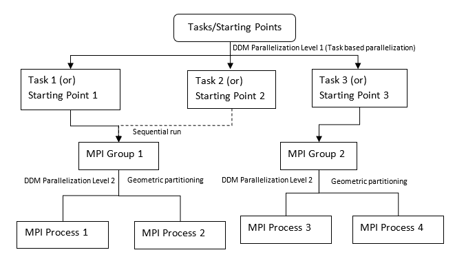

Each task/starting point is then solved sequentially by an MPI group. Each MPI group
consists of one or more MPI Processes. If an MPI group consists of multiple MPI
processes, then the task/starting point is solved by geometric partitioning in that
MPI group (the number of MPI processes in a group is equal to the number of
geometric partitions. Refer to Supported Solution Sequences for DDM Level 2 Parallelization (Geometric Partitioning) for solutions that

-np 4
-ddm, and
PARAM,DDMNGRPS,2
(assigns 3 Buckling subcases/starting points to DDM MPI groups,
sequentially. Subsequently, geometric partitioning is done within each MPI
| Solution | Activation | Level 1 | Level 2 | Grouping |

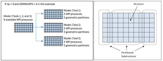

| General Analysis/Optimization runs (DDM) | Use -np # -ddmDefault is Hybrid DDM with PARAM,DDMNGRPS,AUTO. PARAM,DDMNGRPS,<ngrps> is optional. |
Loadcases, loading Frequencies (Task-based parallelization) Refer to Table 1 for supported solutions). | Each loadcase/loading frequency is geometrically partitioned and solved in parallel by an MPI group (if the MPI group contains multiple MPI processes). | Grouping via
PARAM,DDMNGRPS,AUTO
is the default. If you need to adjust number of MPI groups, use
PARAM,DDMNGRPS,<ngrps> Like
the above scenario, if |
| Multi-Model Optimization (MMO) with DDM | Use -np #
-mmoPARAM,DDMNGRPS is not supported with MMO |
Optimization models are parallelized wherein extra MPI
processes (> no of models plus 1) are distributed evenly to
models in main MMO file (or user- defined -np
for each model in main file). |
Any MMO optimization model is geometrically partitioned and solved in parallel (number of partitions depends on number of MPI processes/np assigned to it). | There is no grouping via PARAM,DDMNGRPS as it is not supported for MMO. However, grouping is indirectly accomplished by automatic distribution of np to the MMO models or by explicit user input via Main file. |
