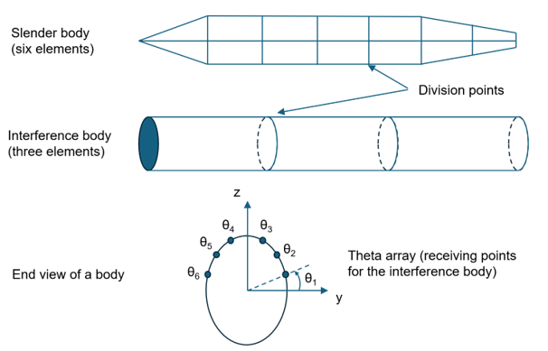

- The half-widths (given on AEFACT entries referenced in fields 6 and 7) are specified at division points. The number of entries on an AEFACT entry used to specify half-widths must be one greater than the number of elements.
- THIi and THNi are interference element numbers on a body. The first element is one for each body. If THI1~3 and THN1~3 are all defined, the union of [THI1, THN1], [THI2, THN2] and [THI3, THN3] defines the complete set of interference elements using the θ1 array.
- A body is represented by a slender
body surrounded by an interference tube. The slender body creates the
downwash due to the motion of the body, while the interference tube
represents the effects upon panels and other bodies.
Figure 1. Idealization of Aerodynamic Body
- The angles θ1 and θ2 are input in degrees using the aerodynamic element coordinate system as the reference coordinate system for defining the theta points.
- Distribution of the theta points does not need to be uniform. A theta point must be placed a finite distance (instead of zero distance) from any aerodynamic box edge; preferably the box edge is equidistant from any two theta points located on the two sides of that box.
- For half models, the theta arrays LTH1 and LTH2 should encompass a full 360-degree range.
