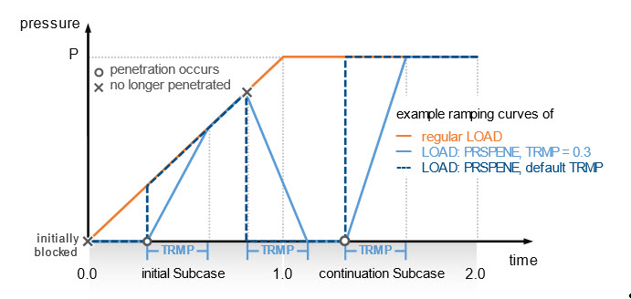

- The external force applied could
change frequently at grid points subjected to pressure penetration load. The
field, TRMP controls the time period, relative to the
entire subcase time, over which the pressures at contact status change are
to be ramped up or down. shows an example load ramping
curves of grid points which are subjected to PRSPENE
referenced by a Subcase Information Entry LOAD, in
comparison with a ramping curve of a regular LOAD. In
this example, the penetration status of the grid point changed three times
over two consecutive nonlinear static subcases. Also,
PRSPENE can be referenced by
DLOAD/TLOADi, and field
TRMP is effective in a similar way.
Figure 1. Example load ramping curves for a grid with pressure penetration load
