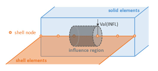

- OptiStruct searches for solid nodes to be included by
segments, and each segment is enclosed by two corner points on the same edge
of a shell element. The influence region is a cylindrical volume for each
segment on the shell edge, whose radius is Val(INFL), as
shown in Figure 1. If PTOL is not
present, the default influence radius will be half the shell thickness.
Figure 1. Influence region at a segment on the shell edge
