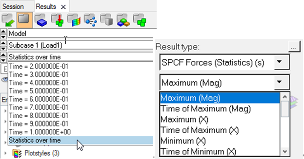

- Single-point force of constraint
statistics are supported for Direct and Modal Linear Transient Analysis.
Only H3D output is supported for single-point force of constraint statistics.
The following statistics over time are output for Transient Analysis when STATIS or is specified.- Statistics
- Supported SPCFORCE Result Types
- Minimum and Time of Minimum
- X-component, Y-component, Z-component
- Maximum and Time of Maximum
- Magnitude, X-component, Y-component, Z-component
- Absolute Maximum and Time of Absolute Maximum
- Arithmetic Mean, Root Mean Square (RMS), Variance, and Standard Deviation
The SPCF statistics can be viewed in HyperView after loading the H3D file, under Statistics over time option at the end of the timestep list in the Results Browser. Then, various statistics can be chosen from the sub-menu under SPCF Forces (Statistics) (s).Figure 1.
