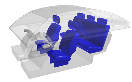

- Fluid-Solid, Same Motion
- When fluid and solid media are in contact with each other and the same motion (or no motion) conditions are applied to each volume the interfacing surfaces will be written out to separate output sets. In the image below the interface surfaces between the cabin air and the seats are written to separate output sets. Sample naming for the pair of output sets is shown below.
