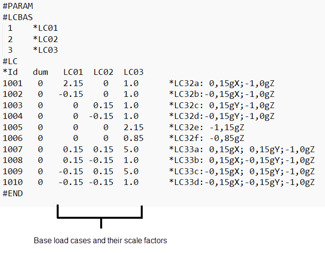

to import the file.
#PARAM and should contain
the following data in the sequence mentioned below:- An
#LCBAStag to indicate the start of base load case definitions. - Base load case data that are to be used in HyperLife Crack Growth – first the ID and then the name, as in the example below. It's required to specify the base load cases for HyperLife Crack Growth to understand which bases cases are used in combinations.
- An
#LCtag to indicate the start of the load combination data. - Load combination data, as shown in the example below.
