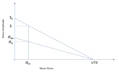

Mean Stress = Constant
  1. Goodman or Soderberg
    When SN curve is of the Stress Ratio R = -1
    S F = s σ a = s e σ a 0 MathType@MTEF@5@5@+= feaagKart1ev2aaatCvAUfeBSjuyZL2yd9gzLbvyNv2CaerbuLwBLn hiov2DGi1BTfMBaeXatLxBI9gBaerbd9wDYLwzYbItLDharqqtubsr 4rNCHbGeaGqiVu0Je9sqqrpepC0xbbL8F4rqqrFfpeea0xe9Lq=Jc9 vqaqpepm0xbba9pwe9Q8fs0=yqaqpepae9pg0FirpepeKkFr0xfr=x fr=xb9adbaqaaeGaciGaaiaabeqaamaabaabaaGcbaGaam4uaiaadA eacqGH9aqpdaWcaaqaaiaadohaaeaacqaHdpWCdaWgaaWcbaGaamyy aaqabaaaaOGaeyypa0ZaaSaaaeaacaWGZbWaaSbaaSqaaiaadwgaae qaaaGcbaGaeq4Wdm3aaSbaaSqaaiaadggadaWgaaadbaGaaGimaaqa baaaleqaaaaaaaa@437B@
    s e MathType@MTEF@5@5@+= feaagKart1ev2aaatCvAUfeBSjuyZL2yd9gzLbvyNv2CaerbuLwBLn hiov2DGi1BTfMBaeXatLxBI9gBaerbd9wDYLwzYbItLDharqqtubsr 4rNCHbGeaGqiVu0Je9sqqrpepC0xbbL8F4rqqrFfpeea0xe9Lq=Jc9 vqaqpepm0xbba9pwe9Q8fs0=yqaqpepae9pg0FirpepeKkFr0xfr=x fr=xb9adbaqaaeGaciGaaiaabeqaamaabaabaaGcbaGaam4CamaaBa aaleaacaWGLbaabeaaaaa@3804@ = Target stress amplitude against the target life from the modified SN curve
    σ a 0 MathType@MTEF@5@5@+= feaagKart1ev2aaatCvAUfeBSjuyZL2yd9gzLbvyNv2CaerbuLwBLn hiov2DGi1BTfMBaeXatLxBI9gBaerbd9wDYLwzYbItLDharqqtubsr 4rNCHbGeaGqiVu0Je9sqqrpepC0xbbL8F4rqqrFfpeea0xe9Lq=Jc9 vqaqpepm0xbba9pwe9Q8fs0=yqaqpepae9pg0FirpepeKkFr0xfr=x fr=xb9adbaqaaeGaciGaaiaabeqaamaabaabaaGcbaGaeq4Wdm3aaS baaSqaaiaadggadaWgaaadbaGaaGimaaqabaaaleqaaaaa@39BD@ = Stress amplitude after mean stress correction

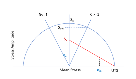

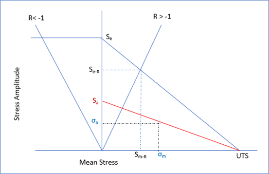

    When SN curve is of the Stress Ratio R != -1
    σ a MathType@MTEF@5@5@+= feaahqart1ev3aaatCvAUfeBSjuyZL2yd9gzLbvyNv2CaerbuLwBLn hiov2DGi1BTfMBaeXatLxBI9gBaerbd9wDYLwzYbItLDharqqtubsr 4rNCHbGeaGqiVu0Je9sqqrpepC0xbbL8F4rqqrFfpeea0xe9Lq=Jc9 vqaqpepm0xbba9pwe9Q8fs0=yqaqpepae9pg0FirpepeKkFr0xfr=x fr=xb9adbaqaaeGaciGaaiaabeqaamaabaabaaGcbaaeaaaaaaaaa8 qacqaHdpWCpaWaaSbaaSqaa8qacaWGHbaapaqabaaaaa@3916@ = Stress Amplitude
    σ m MathType@MTEF@5@5@+= feaahqart1ev3aaatCvAUfeBSjuyZL2yd9gzLbvyNv2CaerbuLwBLn hiov2DGi1BTfMBaeXatLxBI9gBaerbd9wDYLwzYbItLDharqqtubsr 4rNCHbGeaGqiVu0Je9sqqrpepC0xbbL8F4rqqrFfpeea0xe9Lq=Jc9 vqaqpepm0xbba9pwe9Q8fs0=yqaqpepae9pg0FirpepeKkFr0xfr=x fr=xb9adbaqaaeGaciGaaiaabeqaamaabaabaaGcbaaeaaaaaaaaa8 qacqaHdpWCpaWaaSbaaSqaa8qacaWGTbaapaqabaaaaa@3922@ = Mean Stress
    S e − R MathType@MTEF@5@5@+= feaahqart1ev3aaatCvAUfeBSjuyZL2yd9gzLbvyNv2CaerbuLwBLn hiov2DGi1BTfMBaeXatLxBI9gBaerbd9wDYLwzYbItLDharqqtubsr 4rNCHbGeaGqiVu0Je9sqqrpepC0xbbL8F4rqqrFfpeea0xe9Lq=Jc9 vqaqpepm0xbba9pwe9Q8fs0=yqaqpepae9pg0FirpepeKkFr0xfr=x fr=xb9adbaqaaeGaciGaaiaabeqaamaabaabaaGcbaaeaaaaaaaaa8 qacaWGtbWdamaaBaaaleaapeGaamyzaiabgkHiTiaadkfaa8aabeaa aaa@39F3@ = Endurance limit obtained from SN curve with R ratio
    S e − m MathType@MTEF@5@5@+= feaahqart1ev3aaatCvAUfeBSjuyZL2yd9gzLbvyNv2CaerbuLwBLn hiov2DGi1BTfMBaeXatLxBI9gBaerbd9wDYLwzYbItLDharqqtubsr 4rNCHbGeaGqiVu0Je9sqqrpepC0xbbL8F4rqqrFfpeea0xe9Lq=Jc9 vqaqpepm0xbba9pwe9Q8fs0=yqaqpepae9pg0FirpepeKkFr0xfr=x fr=xb9adbaqaaeGaciGaaiaabeqaamaabaabaaGcbaaeaaaaaaaaa8 qacaWGtbWdamaaBaaaleaapeGaamyzaiabgkHiTiaad2gaa8aabeaa aaa@3A0E@ = Mean Stress corresponding to S e − R MathType@MTEF@5@5@+= feaahqart1ev3aaatCvAUfeBSjuyZL2yd9gzLbvyNv2CaerbuLwBLn hiov2DGi1BTfMBaeXatLxBI9gBaerbd9wDYLwzYbItLDharqqtubsr 4rNCHbGeaGqiVu0Je9sqqrpepC0xbbL8F4rqqrFfpeea0xe9Lq=Jc9 vqaqpepm0xbba9pwe9Q8fs0=yqaqpepae9pg0FirpepeKkFr0xfr=x fr=xb9adbaqaaeGaciGaaiaabeqaamaabaabaaGcbaaeaaaaaaaaa8 qacaWGtbWdamaaBaaaleaapeGaamyzaiabgkHiTiaadkfaa8aabeaa aaa@39F3@
    If R   >   − 1 MathType@MTEF@5@5@+= feaahqart1ev3aaatCvAUfeBSjuyZL2yd9gzLbvyNv2CaerbuLwBLn hiov2DGi1BTfMBaeXatLxBI9gBaerbd9wDYLwzYbItLDharqqtubsr 4rNCHbGeaGqiVu0Je9sqqrpepC0xbbL8F4rqqrFfpeea0xe9Lq=Jc9 vqaqpepm0xbba9pwe9Q8fs0=yqaqpepae9pg0FirpepeKkFr0xfr=x fr=xb9adbaqaaeGaciGaaiaabeqaamaabaabaaGcbaWaaSbaaSqaaa baaaaaaaaapeGaamOuaiaabccacqGH+aGpcaqGGaGaeyOeI0IaaGym aaWdaeqaaaaa@3B1B@ , s e = S e − R 1 − s m − R U T S MathType@MTEF@5@5@+= feaahqart1ev3aqatCvAUfeBSjuyZL2yd9gzLbvyNv2CaerbuLwBLn hiov2DGi1BTfMBaeXatLxBI9gBaerbd9wDYLwzYbItLDharqqtubsr 4rNCHbGeaGqiVCI8FfYJH8YrFfeuY=Hhbbf9v8qqaqFr0xc9pk0xbb a9q8WqFfeaY=biLkVcLq=JHqpepeea0=as0Fb9pgeaYRXxe9vr0=vr 0=vqpWqaaeaabiGaciaacaqabeaadaqaaqaaaOqaaabaaaaaaaaape Gaam4Ca8aadaWgaaWcbaWdbiaadwgaa8aabeaak8qacqGH9aqpdaWc aaWdaeaapeGaam4ua8aadaWgaaWcbaWdbiaadwgacqGHsislcaWGsb aapaqabaaakeaapeGaaGymaiabgkHiTmaalaaapaqaa8qacaWGZbWd amaaBaaaleaapeGaamyBaiabgkHiTiaadkfaa8aabeaaaOqaa8qaca WGvbGaamivaiaadofaaaaaaaaa@4612@
    s m − R = S e − R .   1 + R 1 − R MathType@MTEF@5@5@+= feaahqart1ev3aqatCvAUfeBSjuyZL2yd9gzLbvyNv2CaerbuLwBLn hiov2DGi1BTfMBaeXatLxBI9gBaerbd9wDYLwzYbItLDharqqtubsr 4rNCHbGeaGqiVCI8FfYJH8YrFfeuY=Hhbbf9v8qqaqFr0xc9pk0xbb a9q8WqFfeaY=biLkVcLq=JHqpepeea0=as0Fb9pgeaYRXxe9vr0=vr 0=vqpWqaaeaabiGaciaacaqabeaadaqaaqaaaOqaaabaaaaaaaaape Gaam4Ca8aadaWgaaWcbaWdbiaad2gacqGHsislcaWGsbaapaqabaGc peGaeyypa0Jaam4ua8aadaWgaaWcbaWdbiaadwgacqGHsislcaWGsb aapaqabaGcpeGaaiOlaiaacckadaWcaaWdaeaapeGaaGymaiabgUca Riaadkfaa8aabaWdbiaaigdacqGHsislcaWGsbaaaaaa@4642@
    If R   <   − 1 MathType@MTEF@5@5@+= feaahqart1ev3aaatCvAUfeBSjuyZL2yd9gzLbvyNv2CaerbuLwBLn hiov2DGi1BTfMBaeXatLxBI9gBaerbd9wDYLwzYbItLDharqqtubsr 4rNCHbGeaGqiVu0Je9sqqrpepC0xbbL8F4rqqrFfpeea0xe9Lq=Jc9 vqaqpepm0xbba9pwe9Q8fs0=yqaqpepae9pg0FirpepeKkFr0xfr=x fr=xb9adbaqaaeGaciGaaiaabeqaamaabaabaaGcbaWaaSbaaSqaaa baaaaaaaaapeGaamOuaiaabccacqGH8aapcaqGGaGaeyOeI0IaaGym aaWdaeqaaaaa@3B17@ , S e = S e − R MathType@MTEF@5@5@+= feaahqart1ev3aqatCvAUfeBSjuyZL2yd9gzLbvyNv2CaerbuLwBLn hiov2DGi1BTfMBaeXatLxBI9gBaerbd9wDYLwzYbItLDharqqtubsr 4rNCHbGeaGqiVCI8FfYJH8YrFfeuY=Hhbbf9v8qqaqFr0xc9pk0xbb a9q8WqFfeaY=biLkVcLq=JHqpepeea0=as0Fb9pgeaYRXxe9vr0=vr 0=vqpWqaaeaabiGaciaacaqabeaadaqaaqaaaOqaaabaaaaaaaaape Gaam4ua8aadaWgaaWcbaWdbiaadwgaa8aabeaak8qacqGH9aqpcaWG tbWdamaaBaaaleaapeGaamyzaiabgkHiTiaadkfaa8aabeaaaaa@3D25@
    If σ m >   0 MathType@MTEF@5@5@+= feaahqart1ev3aaatCvAUfeBSjuyZL2yd9gzLbvyNv2CaerbuLwBLn hiov2DGi1BTfMBaeXatLxBI9gBaerbd9wDYLwzYbItLDharqqtubsr 4rNCHbGeaGqiVu0Je9sqqrpepC0xbbL8F4rqqrFfpeea0xe9Lq=Jc9 vqaqpepm0xbba9pwe9Q8fs0=yqaqpepae9pg0FirpepeKkFr0xfr=x fr=xb9adbaqaaeGaciGaaiaabeqaamaabaabaaGcbaaeaaaaaaaaa8 qacqaHdpWCpaWaaSbaaSqaa8qacaWGTbaapaqabaGcdaWgaaWcbaWd biabg6da+iaabccacaaIWaaapaqabaaaaa@3BDC@ , s a = σ a 1 − σ m U T S MathType@MTEF@5@5@+= feaahqart1ev3aqatCvAUfeBSjuyZL2yd9gzLbvyNv2CaerbuLwBLn hiov2DGi1BTfMBaeXatLxBI9gBaerbd9wDYLwzYbItLDharqqtubsr 4rNCHbGeaGqiVCI8FfYJH8YrFfeuY=Hhbbf9v8qqaqFr0xc9pk0xbb a9q8WqFfeaY=biLkVcLq=JHqpepeea0=as0Fb9pgeaYRXxe9vr0=vr 0=vqpWqaaeaabiGaciaacaqabeaadaqaaqaaaOqaaabaaaaaaaaape Gaam4Ca8aadaWgaaWcbaWdbiaadggaa8aabeaak8qacqGH9aqpdaWc aaWdaeaapeGaeq4Wdm3damaaBaaaleaapeGaamyyaaWdaeqaaaGcba WdbiaaigdacqGHsisldaWcaaWdaeaapeGaeq4Wdm3damaaBaaaleaa peGaamyBaaWdaeqaaaGcbaWdbiaadwfacaWGubGaam4uaaaaaaaaaa@4438@
    If σ m ≤ 0 MathType@MTEF@5@5@+= feaahqart1ev3aaatCvAUfeBSjuyZL2yd9gzLbvyNv2CaerbuLwBLn hiov2DGi1BTfMBaeXatLxBI9gBaerbd9wDYLwzYbItLDharqqtubsr 4rNCHbGeaGqiVu0Je9sqqrpepC0xbbL8F4rqqrFfpeea0xe9Lq=Jc9 vqaqpepm0xbba9pwe9Q8fs0=yqaqpepae9pg0FirpepeKkFr0xfr=x fr=xb9adbaqaaeGaciGaaiaabeqaamaabaabaaGcbaaeaaaaaaaaa8 qacqaHdpWCpaWaaSbaaSqaa8qacaWGTbaapaqabaGcdaWgaaWcbaWd biabgsMiJkaaicdaa8aabeaaaaa@3BE6@ , s a = σ a MathType@MTEF@5@5@+= feaahqart1ev3aqatCvAUfeBSjuyZL2yd9gzLbvyNv2CaerbuLwBLn hiov2DGi1BTfMBaeXatLxBI9gBaerbd9wDYLwzYbItLDharqqtubsr 4rNCHbGeaGqiVCI8FfYJH8YrFfeuY=Hhbbf9v8qqaqFr0xc9pk0xbb a9q8WqFfeaY=biLkVcLq=JHqpepeea0=as0Fb9pgeaYRXxe9vr0=vr 0=vqpWqaaeaabiGaciaacaqabeaadaqaaqaaaOqaaabaaaaaaaaape Gaam4Ca8aadaWgaaWcbaWdbiaadggaa8aabeaak8qacqGH9aqpcqaH dpWCpaWaaSbaaSqaa8qacaWGHbaapaqabaaaaa@3C64@
    SF=  S e S a MathType@MTEF@5@5@+= feaahqart1ev3aqatCvAUfeBSjuyZL2yd9gzLbvyNv2CaerbuLwBLn hiov2DGi1BTfMBaeXatLxBI9gBaerbd9wDYLwzYbItLDharqqtubsr 4rNCHbGeaGqiVCI8FfYJH8YrFfeuY=Hhbbf9v8qqaqFr0xc9pk0xbb a9q8WqFfeaY=biLkVcLq=JHqpepeea0=as0Fb9pgeaYRXxe9vr0=vr 0=vqpWqaaeaabiGaciaacaqabeaadaqaaqaaaOqaaabaaaaaaaaape Gaam4uaiaadAeacqGH9aqpcaGGGcWaaSaaa8aabaWdbiaadofapaWa aSbaaSqaa8qacaWGLbaapaqabaaakeaapeGaam4ua8aadaWgaaWcba Wdbiaadggaa8aabeaaaaaaaa@3E53@

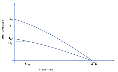

  2. Gerber
    Figure 3.
    Figure 4.

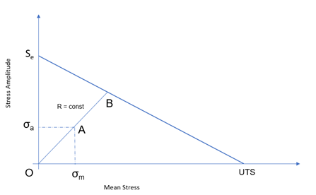

Stress Ratio = Constant
  1. Goodman
    S F = O B O A = 1 ( σ a s e + σ m U T S ) MathType@MTEF@5@5@+= feaagKart1ev2aaatCvAUfeBSjuyZL2yd9gzLbvyNv2CaerbuLwBLn hiov2DGi1BTfMBaeXatLxBI9gBaerbd9wDYLwzYbItLDharqqtubsr 4rNCHbGeaGqiVu0Je9sqqrpepC0xbbL8F4rqqrFfpeea0xe9Lq=Jc9 vqaqpepm0xbba9pwe9Q8fs0=yqaqpepae9pg0FirpepeKkFr0xfr=x fr=xb9adbaqaaeGaciGaaiaabeqaamaabaabaaGcbaGaam4uaiaadA eacqGH9aqpdaWcaaqaaiaad+eacaWGcbaabaGaam4taiaadgeaaaGa eyypa0ZaaSaaaeaacaaIXaaabaWaaeWaaeaadaWcaaqaaiabeo8aZn aaBaaaleaacaWGHbaabeaaaOqaaiaadohadaWgaaWcbaGaamyzaaqa baaaaOGaey4kaSYaaSaaaeaacqaHdpWCdaWgaaWcbaGaamyBaaqaba aakeaacaWGvbGaamivaiaadofaaaaacaGLOaGaayzkaaaaaaaa@4AAD@
    Figure 6.

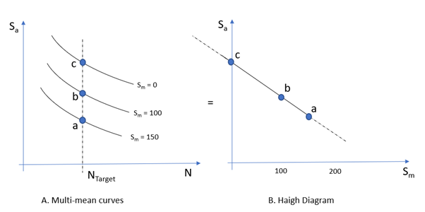

    Safety Factor with Multi-Mean
    To calculate safety factor, HyperLife creates an internal Haigh diagram for the target life using multi-mean SN curve by finding stress amplitude-mean stress pairs at the target life. Using the internally created Haigh diagram, HyperLife calculates safety factor as described in section Safety Factor in Chapter Haigh diagram. The number of data points of the Haigh diagram is the number of curves. Thus the more number of curves, the better result. When Haigh diagram is not available in mean stress ranges, HyperLife extrapolates the Haigh diagram.
    Figure 7. Conversion of Multi-Mean Curve to Haigh Diagram

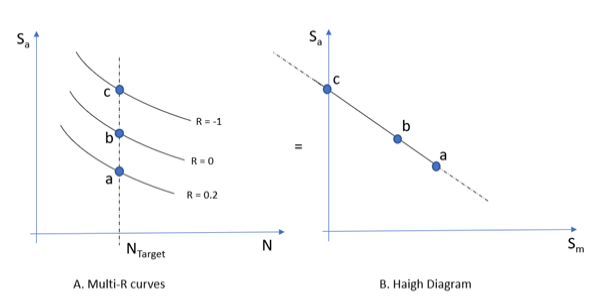

    Safety Factor with Multi-Ratio
    To calculate safety factor, HyperLife create an internal Haigh diagram for the target life using multi-mean SN curve by finding stress amplitude-mean stress pairs at the target life. The number of data points of the Haigh diagram is the number of curves. Thus, the more number of curves, the better result. When Haigh diagram is not available in mean stress ranges, HyperLife extrapolates the Haigh diagram.
    Figure 8. Conversion of Multi-Mean Curve to Haigh Diagram

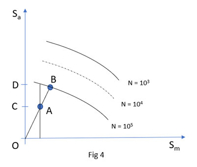

    Safety Factor with Haigh
    Safety factor (SF) is calculated in the following manner in Figure 9.
    Figure 9.
    When target life is 100000:
    • Constant R : SF = OB/OA
    • Constant mean : SF = OD/OC
    If Haigh diagram for a target life is not defined, HyperLife creates Haigh diagram for the target life. In Figure 9, if target life is 10000, and Haigh diagram for N=10000 is not defined, HyperLife will created dashed curve to calculate Safety factor.
