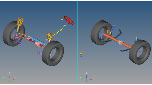

The drivetrain can be included in any front or rear suspensions. Drivetrains are included so their motion can be studied, and also so that the loads can be applied into the suspension via the drivetrain to simulate the true vehicle performance. The drivetrain includes a differential, and either Hookes joints or Constant Velocity joints where appropriate in the system. Front-wheel drive, rear-wheel drive and all-wheel drive systems are represented. A reduction style four-wheel drive transfer case is not included, but can be built manually in the MotionView interface. Two different drivetrain systems are shown in the image below:
Figure 1. Left: Front Suspension with a Differential and Two Half-Shafts; Right; Solid Axle Drivetrain with a Differential and Two Axle Shafts

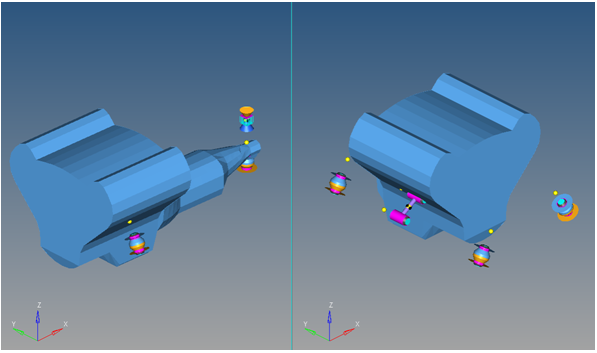

Option Description Body fixed to ground Include a vehicle body part in the model. Instrumentation Front Subframe Include an isolated front subframe. Front Suspensions Select one of the available front suspensions. Steering Linkages Select one of the three types of steering systems. Powertrain The powertrain consists of an engine body and a series of engine mounts that are modeled using bushings. In transverse mounted engines, one or more “dog bone” style mounts may be included in the model. The event included in this model applies a torque at the transmission output shaft. This system is designed to simulate the engine motion during acceleration and braking events, and act as one of the building blocks for full vehicle modeling. Figure 2. Left: Longitudinal Engine; Right: Transverse Engine
Note: Internal engine mechanisms are not modeled. -
