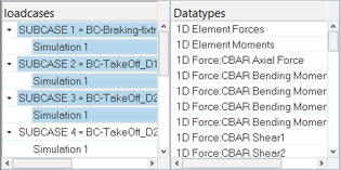

A new dialog opens, and all of the available (native and derived) load cases are displayed.
Use the arrows to view relevant file IDs that the subcases/simulation are
from.
This is useful in cases where the same subcase ID is present in multiple subcases.
Select one or more entries from the loadcases.

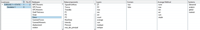

The data type entry is populated. The data types shown are the common ones from the selected loadcases.
Figure 3.
Select one data type for each query.
Once the data type is selected, related data components, layers, corners, the average method and systems are populated.
- Data Type [single selection per query]
- Data Component [multiple selection per query]
- Layer [multiple selection per query]
- Corner Data [single selection per query, default = centroid+corner nodes]
- Averaging Method [single selection per query, default = none]
- System [single selection per query, default = analysis system]
You can select multiple data components, multiple layers, single corner option,
single average method and single system.

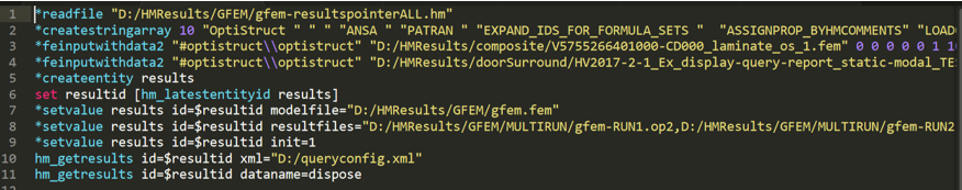

The queryconfig.tcl will be used in the batch mode to implement the loading of model/result sets for the creation of the result entity, while the queryconfig.xml is the main file storing all query set up from the interactive mode. These files can be modified by changing global or local settings for each query.

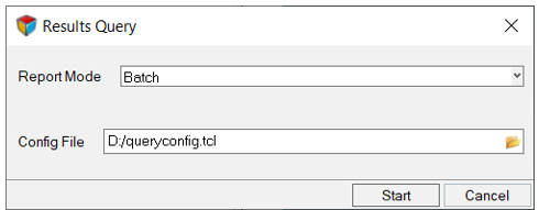

Perform Queries on Result Types - Batch Mode
Restriction: Only available in the Nastran, OptiStruct, Abaqus, and ANSYS user profiles.
From the Post ribbon, click Tools.
Figure 5.
Select Batch.
Figure 6.
Click Start.
The utility creates a new instance, loads the model and results, creates the result entity and uses the settings defined in the .xml file.
