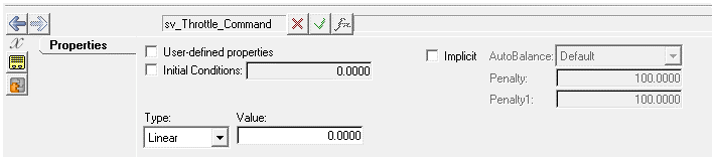

Right-click SolverVariable
from the toolbar to display the
Add SolverVariable dialog.
- For Label, enter Throttle_Command.
For Variable, enter sv_Throttle_Command and
click OK.
Repeat the steps a-c to create the Pitch and Roll solver variables.
- Label
- Variable
- Roll_Command
- sv_Roll_Command
- Pitch_Command
- sv_Pitch_Command
