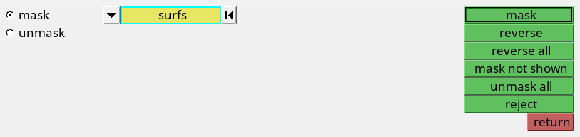

Each panel contains input controls that allow you to enter necessary information for the procedures you wish to perform. If you press a function button and the data is incorrect or required information is missing, a message is displayed in the status bar stating the error. You can press the Esc key or click return to exit a panel. Returning out of a panel means accepting what was performed on the model while using the panel. This cannot be rejected once the panel is exited.

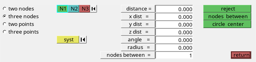

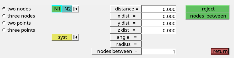

Subpanel
To select a subpanel, click the radio button next to the subpanel name on the left side of the panel.

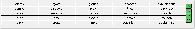

Pull-Down Selections
- Go directly to the first page of the list.
- Step backward one page toward the beginning of the list.
- Advance one page toward the end of the list.
- Go directly to the last page of the list.
