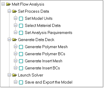

Melt Flow Analysis Tab
The steps used to create the data deck are represented using check boxes. These steps are:
| - | Select the material data |
| - | Set the analysis requirements |
| - | Save and export the model |
The steps completed and the status is indicated in the project message bar. Click Summary to display information regarding process conditions, materials selected, boundary conditions created and element statistics. Click Close to close the tab and return to the Utility menu.
