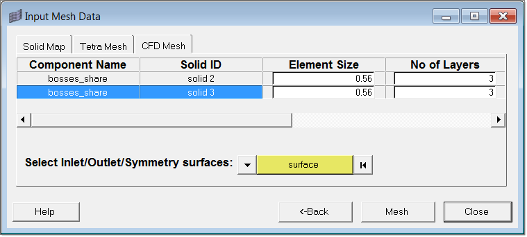

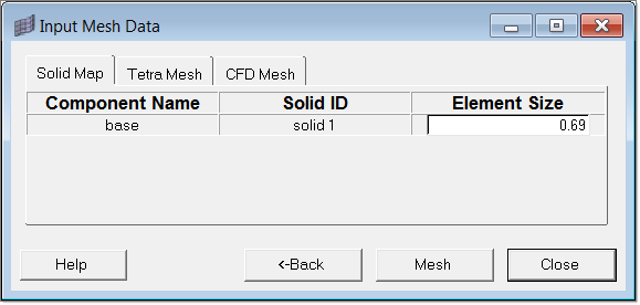

| This panel shows three tabs, once corresponding to each meshing method. Solid Map and Tetra Mesh tabs list the selected components and respective solids with their IDs. It also shows the recommended element size for each solid as shown in the below image. This size can be edited.
 The CFD Mesh tab will display additional meshing parameters relevant to creating boundary layer mesh in addition to the element size, as shown in the below image. Please refer to the help on CFD BL meshing.
 Use this tab to select and specify the surfaces to be considered as inlet/outlet/symmetry surfaces for the purpose of creating a boundary layer mesh. Refer to the CFD mesh help for better understanding of the above mesh parameters. Complete the mesh by clicking Mesh.
