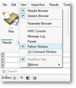

Interacting with the application clients via Python API can be done in multiple ways. Direct execution of API calls can be performed using the IPython console, which can be activated in the View pull down menu by clicking on Python Window.
Figure 1. View pulldown menu.

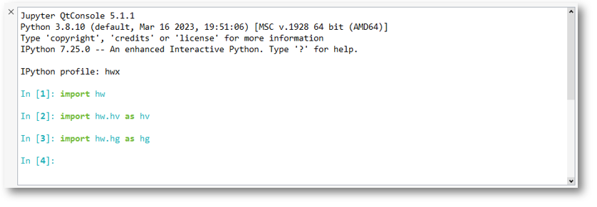

Once you are in the console, you can execute standard Python calls and import various packages you intend to work with:
import hwwill give you access to the framework classes and functions (see hw Module).import hmwill give you access to HyperMesh client classes and functions (see hm Module).import hm.entitieswill give you access to HyperMesh client entity classes (see hm.entities Module).import hw.hvwill import the HyperView classes (see hw.hv Module).import hw.hgwill import the HyperGraph and TableView classes (see hw.hg Module and hw.hg Module for TableView).import hw.taskmanagerwill import the Task Manager classes (see hw.taskmanager Module).import reportwill import the Reporting classes (see report Package).import hwx.guiwill import the GUI Toolkit classes (see GUI Toolkit).
Figure 2. Python Window.
The Python 3.8.10 distribution included in the HyperMesh installation includes hundreds of popular packages and libraries like Pandas, NumPy, SciPy,
TensorFlow, openpyxl, etc. You can retrieve a full list of accessible Python modules by calling help("modules")
