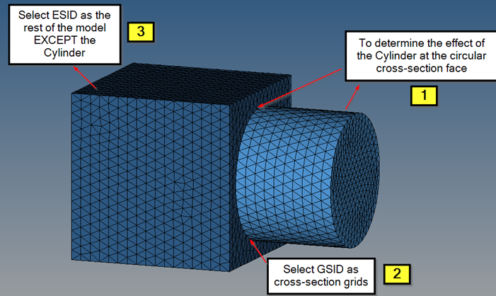

  33. The Resultant Section Force and Resultant Section Moment can be specified as responses via RTYPE=RESFORCE. The ATTA field specifies whether Resultant Section Force components (1,2,3) or Resultant Section Moment components (4,5,6) are selected. The ATTi fields should reference the Identification Numbers of the SECTION Bulk Data Entry that define the cross-section.
    The SECTION entry can be used to define a face of the cross-section on which the forces/moments are calculated as a response in optimization runs via RTYPE=RESFORCE (on the DRESP1 entry). In such cases, Grid Point Forces or Moments are added at each GRID specified within the grid set (GSID). The effect of all elements on the grid points (GSID) is considered in the calculation of the response except the elements specified via ESID. The section is determined through a set of Grid points and the particular face is specified by a set of elements. The face is interpreted as the side of the Grid point set NOT containing the specified elements (refer to SECTION). This is similarly applicable to Rigid Element sets through RSID.
    Figure 1. Define the SECTION for the RESFORCE Response
    section_resforce

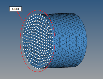

    Figure 2. Select the GSID Set
    section_gsid

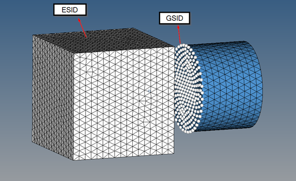

    Figure 3. Select the Corresponding ESID
    section_esid
