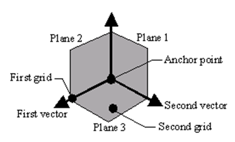

PATRN Indicates that variable pattern grouping is active. Indicates that information about the pattern group will follow.
TYP Variable pattern grouping type. Required if any symmetry or variable pattern grouping is desired. 1
0 (Default)
No pattern grouping
10
1-plane symmetry
20
2-plane symmetry
30
2-plane symmetry
1-plane symmetry is supported for both CLASSIC and VERTEXM.
2- and 3-plane symmetries are available only for VERTEXM.
(Integer)

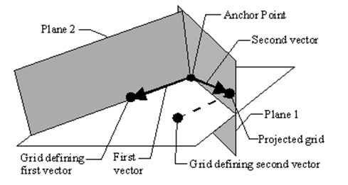

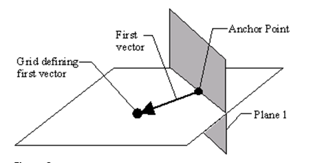

AID/XA, YA, ZA Variable pattern grouping anchor nodes.
These fields define a point that determines how grids are grouped into variables. 1
The point may be defined by entering a grid ID in the SID field or by entering X, Y, and Z coordinates in the XS, YS, and ZS fields. These coordinates are in the global coordinate system.
Default = origin (Real in all three fields or Integer in AID/XA field)
FID/XF, YF, ZF Direction of first vector for variable pattern grouping. These fields define an xyz vector which determines how grids are grouped into variables. 1
The X, Y, and Z coordinates are in the global coordinate system.
If FID is defined, it defines a vector pointing from grid AID or point (XA, YA, and ZA) to grid FID.
If XF, YF, ZF are defined, it defines a vector pointing from point (XA, YA, and ZA) to point (XA+XF,YA+YF,ZA+ZF). (XA, YA, and ZA) are coordinates of the anchor point defined by AID or XA, YA, and ZA.
If all fields are blank and the TYP field is not blank or zero, OptiStruct returns an error.
No default
SID/XS, YS, ZS Direction used to determine second vector for variable pattern grouping. 1
These fields define a xyz vector which, when combined with the first vector, form a plane. The second vector is calculated to lie in that plane and is perpendicular to the first vector. The second vector is sometimes required to determine how grids are grouped into variables. The X, Y, and Z values are in the global coordinate system.
You may put a grid ID in the SID/XS field to define the second vector. This vector goes from the anchor point to this grid.
If all fields are blank and the TYP field contains a value of 20 or higher, OptiStruct returns an error.
No default

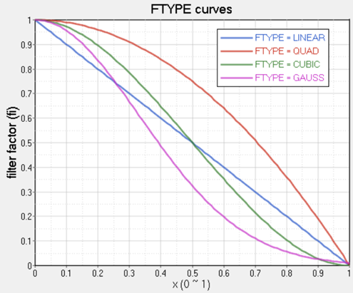

FILTER Indicates that nodal shape sensitivities filtering options are to follow. 3
FTYPE Filtering type of nodal shape sensitivities. It indicates the method of nodal shape sensitivities smoothing.
GAUSS (Default)
LINEAR
QUAD
CUBIC
RADIUS Sensitivities filtering radius. It requires a reasonable value based on average mesh size of design domain. It is recommended that the filter radius is not too small compared to the average mesh size or too large compared to the whole design domain. 2
Default = 4* average mesh size (Real > 0.0)

  3. For a given design node, its smoothed sensitivity is ( ∑ f i g i ∑ f i MathType@MTEF@5@5@+= feaagKart1ev2aaatCvAUfeBSjuyZL2yd9gzLbvyNv2CaerbwvMCKf MBHbqefqvATv2CG4uz3bIuV1wyUbqedmvETj2BSbqefm0B1jxALjhi ov2DaebbnrfifHhDYfgasaacH8srps0lbbf9q8WrFfeuY=Hhbbf9v8 qqaqFr0xc9pk0xbba9q8WqFfea0=yr0RYxir=Jbba9q8aq0=yq=He9 q8qqQ8frFve9Fve9Ff0dmeaacaGacmGadaWaaiqacaabaiaafaaake aadaWcaaqaamaaqaeabaGaamOzamaaBaaaleaacaWGPbaabeaakiaa dEgadaWgbaWcbaGaamyAaaqabaaabeqab0GaeyyeIuoaaOqaaiabgg HiLlaadAgadaWgaaWcbaGaamyAaaqabaaaaaaa@42B9@ ),
    Where,
    f i MathType@MTEF@5@5@+= feaagKart1ev2aaatCvAUfeBSjuyZL2yd9gzLbvyNv2CaerbwvMCKf MBHbqefqvATv2CG4uz3bIuV1wyUbqedmvETj2BSbqefm0B1jxALjhi ov2DaebbnrfifHhDYfgasaacH8srps0lbbf9q8WrFfeuY=Hhbbf9v8 qqaqFr0xc9pk0xbba9q8WqFfea0=yr0RYxir=Jbba9q8aq0=yq=He9 q8qqQ8frFve9Fve9Ff0dmeaacaGacmGadaWaaiqacaabaiaafaaake aacaWGMbWaaSbaaSqaaiaadMgaaeqaaaaa@3ADC@
    Filtering factor at node #i
    g i MathType@MTEF@5@5@+= feaagKart1ev2aaatCvAUfeBSjuyZL2yd9gzLbvyNv2CaerbwvMCKf MBHbqefqvATv2CG4uz3bIuV1wyUbqedmvETj2BSbqefm0B1jxALjhi ov2DaebbnrfifHhDYfgasaacH8srps0lbbf9q8WrFfeuY=Hhbbf9v8 qqaqFr0xc9pk0xbba9q8WqFfea0=yr0RYxir=Jbba9q8aq0=yq=He9 q8qqQ8frFve9Fve9Ff0dmeaacaGacmGadaWaaiqacaabaiaafaaake aacaWGNbWaaSbaaSqaaiaadMgaaeqaaaaa@3ADD@
    Sensitivity at node #i
    Filtering factor is calculated based on FTYPE, Figure 2 shows the filter factor curves for each FTYPE. Generally filtering factor at this given node is 1.0, since it is at the center, and the node outside RADIUS has zero filtering factor.

    • For 1-plane symmetry (TYP = 10):
      The symmetry plane is defined normal to the first vector (FID/XF, YF, ZF) and is located at the anchor node (AID/XA, YA, ZA).
      Figure 3. Defining the first symmetry plane
    • 2-plane symmetry (TYP = 20):
      The first symmetry plane (Plane 1) is defined normal to the first vector (FID/XF, YF, ZF) and is located at the anchor node, (Figure 3).
      To obtain the second symmetry plane (Plane 2), the second vector is calculated by taking the vector defined in SID/XS, YS, ZS and projecting it onto plane 1. If a grid point was used to define the second vector, the second vector is a vector running from the anchor node to the projected grid point. If a vector was used to define the second vector, the base of the projected vector is placed at the anchor point. The second vector is normal to plane 2, (Figure 4).
      TYP = 20 is applicable only to VERTEXM.
      Figure 4. Defining the first and second symmetry planes
    • 3-plane symmetry (TYP = 30):
      The first and second symmetry planes (Plane 1 and Plane 2) are determined as explained above.
      Plane 3 is determined to be normal to both plane 1 and plane 2, (Figure 5).
      TYP = 30 is applicable only to VERTEXM.
      Figure 5. Defining the first, second and third symmetry planes
