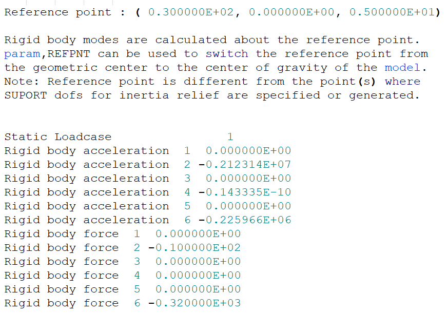

PARAM,PRINFACC,1 can be used to print additional information such as the output of inertial relief rigid body forces and accelerations in the .out file.
These rigid body forces and accelerations are intermediate results from the inertia relief solution. The reference point printed in the .out file is not the point of support location for inertia relief. The reference point is used for rigid body rotation calculation and these rigid body modes are part of the equations used in the calculation of inertia relief.
