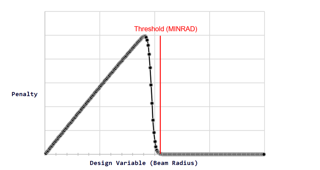

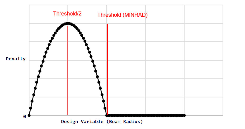

The penalty value for each design variable (beam radius) is calculated based on the chosen method on LATPRM,CLEAN. If YES is selected, then the Heaviside penalty function is used, and the Quadratic penalty function is used, if LESS is selected.
Figure 1. Heaviside Penalty Function for Lattice Sizing+ (LATPRM,CLEAN,YES)
Figure 2. Quadratic Penalty Function for Lattice Sizing+ (LATPRM,CLEAN,LESS)
