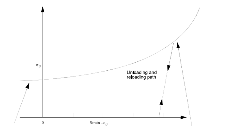

    Figure 1. Stress versus Volumetric Strain
