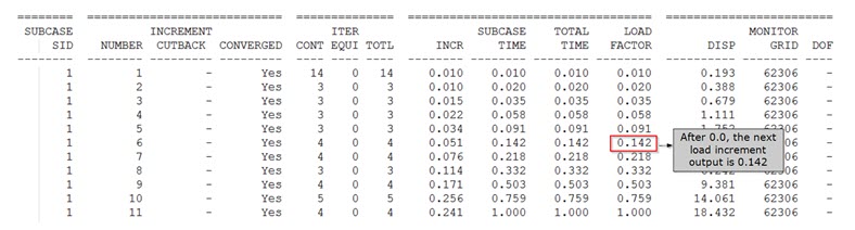

    The following example illustrates the handling of intermediate output when NINT=10 is specified.
    Since NINT=10, the value of 1/NINT is 0.1. Therefore, if the difference in load increment from the previous load level that has already been output to the current load increment is greater than 0.1, then the current load increment is selected for output. For NLOUT, the first and last increments are always output by default. In the following case, the first load step is 0.0 and the final load step is 1.0.
    Since the last output frame was 0.0 (last load increment selected for output), the difference between the next load increment and 0.0 should be greater than 0.1 (1/NINT) for it to be selected for output. As indicated in the .monitor file, printing in Figure 1, the first load increment for H3D NLOUT output after 0.0 is 0.142, since 0.0 subtracted from 0.142 is 0.142; which is greater than 0.1. For all other load increments prior to 0.142, the difference is less than 0.1, leading to them not being selected for output.

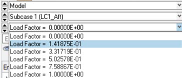

    This is clearly evident in Figure 2 from the corresponding H3D file, as the second increment to be output is 0.142, instead of 0.02 as seen in the .monitor file output in Figure 1.
