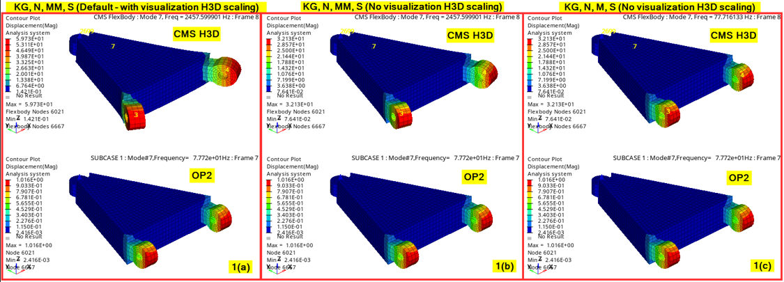

    1. Scaling applied to the Eigenvalues and Eigenvectors in flex H3D due to inconsistent units:
      If the units specified on DTI,UNITS entry in OptiStruct is a set of inconsistent units, there is some scaling applied to both Eigenvalues and Eigenvectors in the flex H3D to account for the inconsistency in the units.
      Even though the flex H3D file is always in KG,N,MM,S, it is still an inconsistent set of units. For instance, even if KG,N,MM,S are the units specified on DTI,UNITS, which matches with the units in which the flex H3D file, the following scaling is applied as it is an inconsistent set of units (for example, instead of 1 MM, it is switched to 1 M (or 1000 MM), meaning the reduced stiffness matrix equation is multiplied by 1000 on both sides):
      s q r t 1000   A o r t T   K   s q r t 1000 A o r t   =   1000 ∗ λ MathType@MTEF@5@5@+= feaahGart1ev3aqatCvAUfeBSjuyZL2yd9gzLbvyNv2CaerbuLwBLn hiov2DGi1BTfMBaeXatLxBI9gBaerbd9wDYLwzYbItLDharqqtubsr 4rNCHbGeaGqiVu0Je9sqqrpepC0xbbL8F4rqqrFfpeea0xe9Lq=Jc9 vqaqpepm0xbba9pwe9Q8fs0=yqaqpepae9pg0FirpepeKkFr0xfr=x fr=xb9adbeqaaeGaciGaaiaabeqaamaabaabaaGcbaWaamWaaeaaca WGZbGaamyCaiaadkhacaWG0bWaaeWaaeaacaaIXaGaaGimaiaaicda caaIWaaacaGLOaGaayzkaaGaaGjcVlaabgeadaqhaaWcbaGaam4Bai aadkhacaWG0baabaGaamivaaaaaOGaay5waiaaw2faaiaayIW7caqG lbGaaGjcVpaadmaabaWaaeWaaeaacaWGZbGaamyCaiaadkhacaWG0b WaaeWaaeaacaaIXaGaaGimaiaaicdacaaIWaaacaGLOaGaayzkaaaa caGLOaGaayzkaaGaaeyqamaaBaaaleaacaWGVbGaamOCaiaadshaae qaaaGccaGLBbGaayzxaaGaaGPaVlabg2da9iaaykW7caaIXaGaaGim aiaaicdacaaIWaGaey4fIOIaeq4UdWgaaa@63C5@
      Therefore, a scaling of 1000 = 31.6 MathType@MTEF@5@5@+= feaahGart1ev3aqatCvAUfeBSjuyZL2yd9gzLbvyNv2CaerbuLwBLn hiov2DGi1BTfMBaeXatLxBI9gBaerbd9wDYLwzYbItLDharqqtubsr 4rNCHbGeaGqiVu0Je9sqqrpepC0xbbL8F4rqqrFfpeea0xe9Lq=Jc9 vqaqpepm0xbba9pwe9Q8fs0=yqaqpepae9pg0FirpepeKkFr0xfr=x fr=xb9adbaqaaeGaciGaaiaabeqaamaabaabaaGcbaWaaOaaaeaaca aIXaGaaGimaiaaicdacaaIWaaaleqaaOGaeyypa0JaaG4maiaaigda caGGUaGaaGOnaaaa@3CF6@ is applied to the eigenvectors and a scaling of 1000 is applied to the eigenvalues.
      As part of this conversion, as eigenvalues are scaled, the corresponding frequency is scaled by:
      f s c a l e d = 1000 * λ 2 π = 1000 λ 2 π = 1000 f = 31.6 f MathType@MTEF@5@5@+= feaahGart1ev3aqatCvAUfeBSjuyZL2yd9gzLbvyNv2CaerbuLwBLn hiov2DGi1BTfMBaeXatLxBI9gBaerbd9wDYLwzYbItLDharqqtubsr 4rNCHbGeaGqiVu0Je9sqqrpepC0xbbL8F4rqqrFfpeea0xe9Lq=Jc9 vqaqpepm0xbba9pwe9Q8fs0=yqaqpepae9pg0FirpepeKkFr0xfr=x fr=xb9adbaqaaeGaciGaaiaabeqaamaabaabaaGcbaGaamOzamaaBa aaleaacaWGZbGaam4yaiaadggacaWGSbGaamyzaiaadsgaaeqaaOGa eyypa0ZaaSaaaeaadaGcaaqaamaabmaabaGaaGymaiaaicdacaaIWa GaaGimaiaacQcacqaH7oaBaiaawIcacaGLPaaaaSqabaaakeaacaaI YaGaeqiWdahaaiabg2da9maakaaabaGaaGymaiaaicdacaaIWaGaaG imaaWcbeaakmaalaaabaWaaOaaaeaacqaH7oaBaSqabaaakeaacaaI YaGaeqiWdahaaiabg2da9maakaaabaGaaGymaiaaicdacaaIWaGaaG imaaWcbeaakiaadAgacqGH9aqpcaaIZaGaaGymaiaac6cacaaI2aGa amOzaaaa@597B@
      This scaling is illustrated in Figure 1 1(b) below, when comparing the flex H3D with the OP2 file. For mode 7, the maximum value of the eigenvector is scaled as 1.016*sqrt(1000) = 1.016*31.6 = 32.13, and the frequency is scaled as 77.72*sqrt(1000) = 77.72*31.6 = 2457.59 Hz.
    2. Scaling applied to the Eigenvectors in flex H3D due to mismatch of units between DTI,UNITS and default Flex H3D units of KG,N,MM,S:
      If the units specified on DTI,UNITS entry in OptiStruct (even if it is a consistent set) is different from the default flex H3D units of KG,N,MM,S, scaling is applied to Eigenvectors in the flex H3D to account for the mismatch in the units. For instance, even if KG,N,M,S are the units specified on DTI,UNITS, which is a consistent set of units, it does not match with the units in which the flex H3D file is written out (KG,N,MM,S). In this situation, the following scaling is applied:
      s q r t 1000   A o r t T   K 1000   s q r t 1000 A o r t   =   λ MathType@MTEF@5@5@+= feaahGart1ev3aqatCvAUfeBSjuyZL2yd9gzLbvyNv2CaerbuLwBLn hiov2DGi1BTfMBaeXatLxBI9gBaerbd9wDYLwzYbItLDharqqtubsr 4rNCHbGeaGqiVu0Je9sqqrpepC0xbbL8F4rqqrFfpeea0xe9Lq=Jc9 vqaqpepm0xbba9pwe9Q8fs0=yqaqpepae9pg0FirpepeKkFr0xfr=x fr=xb9adbeqaaeGaciGaaiaabeqaamaabaabaaGcbaWaamWaaeaaca WGZbGaamyCaiaadkhacaWG0bWaaeWaaeaacaaIXaGaaGimaiaaicda caaIWaaacaGLOaGaayzkaaGaaGjcVlaabgeadaqhaaWcbaGaam4Bai aadkhacaWG0baabaGaamivaaaaaOGaay5waiaaw2faaiaayIW7daWc aaqaaiaabUeaaeaacaaIXaGaaGimaiaaicdacaaIWaaaaiaayIW7da WadaqaamaabmaabaGaam4CaiaadghacaWGYbGaamiDamaabmaabaGa aGymaiaaicdacaaIWaGaaGimaaGaayjkaiaawMcaaaGaayjkaiaawM caaiaabgeadaWgaaWcbaGaam4BaiaadkhacaWG0baabeaaaOGaay5w aiaaw2faaiaaykW7cqGH9aqpcaaMc8Uaeq4UdWgaaa@62E6@
      Therefore, a scaling of 1000 = 31.6 MathType@MTEF@5@5@+= feaahGart1ev3aqatCvAUfeBSjuyZL2yd9gzLbvyNv2CaerbuLwBLn hiov2DGi1BTfMBaeXatLxBI9gBaerbd9wDYLwzYbItLDharqqtubsr 4rNCHbGeaGqiVu0Je9sqqrpepC0xbbL8F4rqqrFfpeea0xe9Lq=Jc9 vqaqpepm0xbba9pwe9Q8fs0=yqaqpepae9pg0FirpepeKkFr0xfr=x fr=xb9adbaqaaeGaciGaaiaabeqaamaabaabaaGcbaWaaOaaaeaaca aIXaGaaGimaiaaicdacaaIWaaaleqaaOGaeyypa0JaaG4maiaaigda caGGUaGaaGOnaaaa@3CF6@ is applied to the eigenvectors and no scaling is applied to the eigenvalues.
      This scaling is illustrated in Figure 1 1(c) below, when comparing the flex H3D with the OP2 file. For mode 7, the maximum value of the eigenvector is scaled as 1.016*sqrt(1000) = 1.016*31.6 = 32.13, and the frequency is not scaled and remains the same.
    3. Visualization scaling for Flex H3D:
      Regardless of the units specified on the DTI,UNITS entry, by default, a scaling is always applied to the flex H3D file purely for visualization purposes (this is to make sure that the deformation of each mode is reasonably visible regardless of model units when the flex H3D file is imported into a post-processor like HyperView for visualization). This is purely for visualization purposes and does not affect the subsequent solution in multi-body dynamics analyses (such as in MotionSolve). The scaling is calculated as the ratio of the maximum deformation of each mode and the physical size of the model. This scaling cannot be turned off or controlled. This scaling is illustrated in Figure 1 1(a) below. Due to additional scaling on the maximum value of the eigenvector, the value changes from 32.13 to 59.73.
