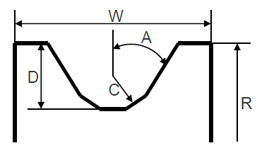

- class Pulley(**kwds)#
- Creates a pulley.
A pulley element, that a cable wraps around, can be used to change the direction of the load applied to the cable.
The Pulley is defined by the following dimensions (see Comment 2):
Pulley profile geometry.#

- active#
Defines the state of the object.
Type=Bool, Default=True, Modifiable
- angle#
The profile angle of the pulley.
Type=Double, Default=40.0

- cradius#
The profile radius of the pulley.
Type=Double, Default=7.5
- dc#
The diameter of the cable wrapped around the pulley.
Type=Double, Default=10.0
- depth#
The profile depth of the pulley.

- radius#
The pulley radius.
Type=Double, Default=100.0

- width#
The profile width of the pulley.
