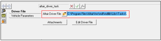

Source the file in the Altair Driver File
browser.
Note: The Edit driver file button can be used to edit the file. -

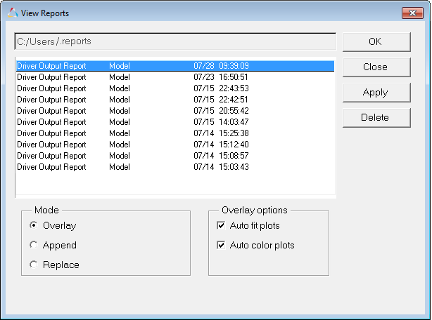

Select the recent run in the View Reports dialog and click
OK.
Figure 4.

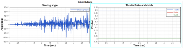

The noise in the steering is numerical error of negligible magnitude – 0 for
all practical purposes. Throttle is constant at 0.5 (driver throttle, brake and
clutch outputs are normalized so, 50%) and brake is constant at 0.
Figure 5.
