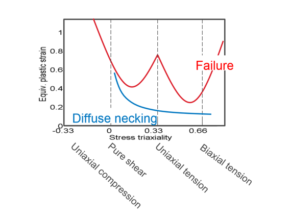

Comments
- The
/FAIL/TAB2 failure criterion is a tabulated criterion
that offers you the freedom to define your own map of plastic strain at
failure with stress triaxiality, Lode parameter and other dependency. This
plastic strain at failure is used to compute a damage variable evolution
described below. This criterion also offers the possibility to generate a
stress softening effect with the damage computation as:Where,

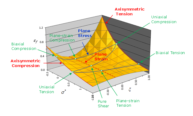

- To use /FAIL/TAB2, it is required to define a
plastic strain at failure used to compute the damage accumulation presented
below. It can be either constant using FCRIT parameter
alone or tabulated if EPSF_ID table identifier is
specified. The tabulated plastic strain at failure is defined with respect
to stress triaxiality, Lode parameter and temperature
(Figure 1). If EPSF_ID is defined, FCRIT becomes a scale factor to quickly increase or decrease the entire plastic strain at failure map.
Figure 1. Tabulated failure criterion map showing the evolution of plastic strain at failure with respect to stress triaxiality and Lode parameter

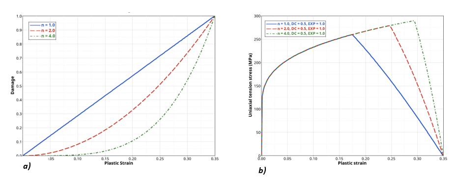

- The damage variable evolution is given by:The parameter N then allows you to change the shape of the damage evolution with plastic strain shape from linear (N = 1, set by default) to nonlinear (N ≠ 1) (Figure 2(a)). An increase of N also creates a delay of the stress softening effect (Figure 2(b)).
Figure 2. Effect of parameter N on the damage variable evolution and the stress softening effect

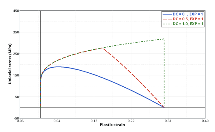

- The DCRIT parameter allows you to define a damage
variable trigger value for stress softening (Figure 3). By default DCRIT
= 0.0, which means that damage variable always has an effect on stress
computation, generating a softening effect from the beginning of the
plasticity. However, you may want to delay this stress softening effect to a
higher value of damage variable (0 < D < 1) or cut the effect of
stress softening to obtain a fully failure criterion approach where elements
lose their load carrying capacity when damage reaches the value 1.
Figure 3. Effect of parameter DCRIT on the stress softening effect

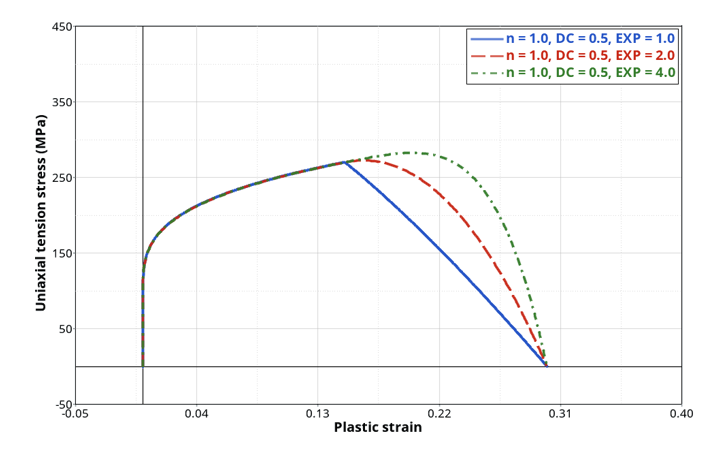

- Even if the shape of the damage accumulation can be controlled with
parameter N, another non-linearity in stress softening
can be defined with the exponent EXP (Figure 5). This exponent can be constant if
EXP parameter is defined alone or can evolve with
element size if FCT_EXP is specified. If the function is
used, EXP_REF is the element reference size and
EXP becomes a scale factor. By default,
EXP is set to 1.0 leading to a linear decrease.
Figure 5. Effect of exponent parameter EXP on the stress softening shape
