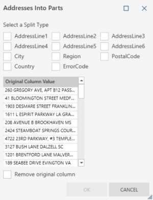

When you apply this transformation, Monarch Data Prep Studio will ask you which of the following name components are available:
Field |
Description |
Address line 1 |
Outputs the first line of data extracted from the input information. |
Address line 2 |
Outputs the second line of data extracted from the input information, provided it is not recognized as a City, Region or Postal Code. |
Address line 3 |
Outputs the third line of data extracted from the input information, provided it is not recognized as a City, Region or Postal Code. |
Address line 4 |
Outputs the fourth line of data extracted from the input information, provided it is not recognized as a City, Region or Postal Code. |
Address line 5 |
Outputs the fifth line of data extracted from the input information, provided it is not recognized as a City, Region or Postal Code. |
Address line 6 |
Outputs the sixth line of data extracted from the input information, provided it is not recognized as a City, Region or Postal Code. |
City |
Outputs the City name extracted from the input information. |
Region |
Outputs the Region name (State, County, etc) extracted from the input information. |
Postal Code |
Outputs the Postal Code extracted from the input information. |
Country |
Outputs the Country name extracted from the input information. |
Error Code |
Outputs the error code, if any are generated by the Address Block engine when parsing the input information. See Using Address Blocks for more information on Address Block error codes. |
Monarch Data Prep Studio will do the postal split depending on the components selected.

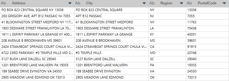

Example
In this example, Address is the original column. It is split into three columns: City, Region, and PostalCode.
