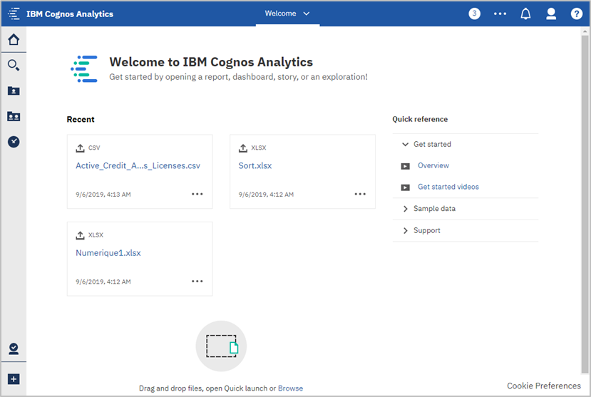

The table you exported should display in My Content when you log into your Cognos Analytics service.
More information on how to get started using IBM Cognos Analytics may be found here.
