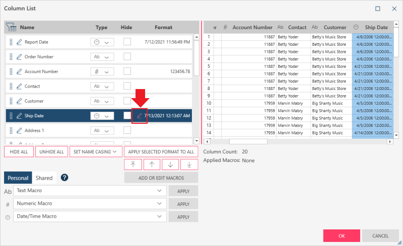

On the Prepare Window, right-click on a column and then select Column List from the context menu. The Column List dialog displays.
Click on the Edit Format icon beside the date column you wish to format:

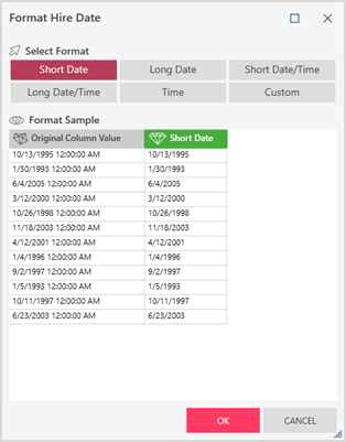

The Format dialog box displays:
Alternatively, you can simply click on the drop-down arrow located to the right of the header of a date/time column and then select Format from the options that display. This will bring up the same Format dialog.

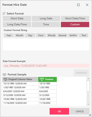

Select a pre-defined date format (Short Date, Long Date, Short Date/Time, Long Date/Time, Time) to apply these formats to your date columns. Alternatively, select Custom to enter your own custom formatting:

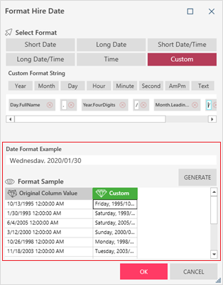

You can create a custom date format using standard date/time parts or by example:
To create a custom format using standard date/time parts, select the date/time parts you wish to apply to your date field from the Custom Format String section of the Format dialog.
To define a custom date format by example, enter a sample custom format into the Date Format Example field. Click the Generate button to produce a sample of what your dates/times will look like when your selected formatting is applied. The format you specified is also added to the Custom Format String field.

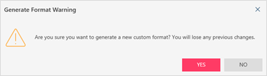

If a custom number format sample had previously been defined, clicking the Generate button displays the following dialog:
Simply click YES to continue applying your custom format.
