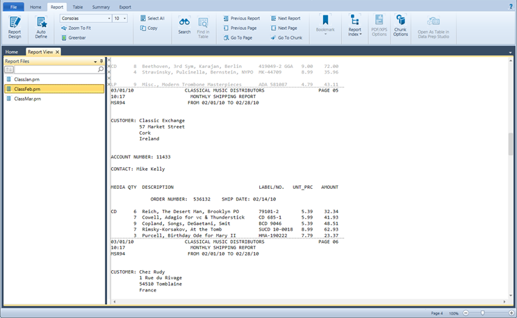

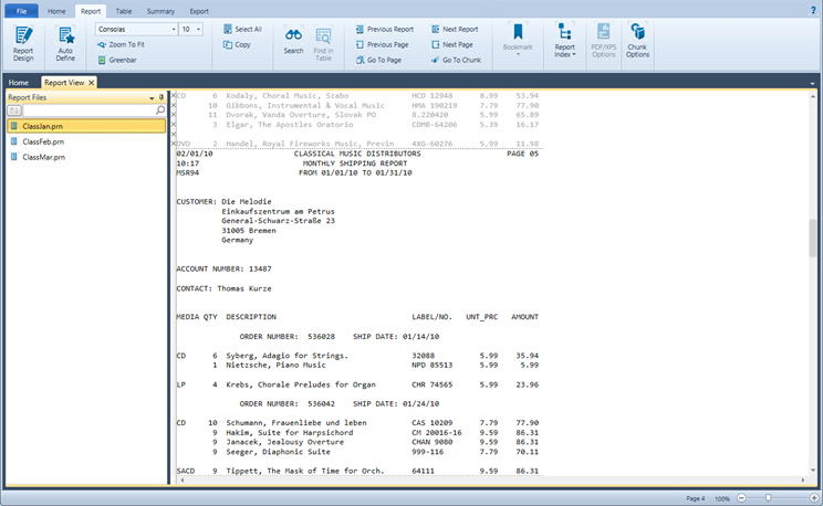

In the example below, Chunk #3 of a 12-page report (chunk size: 2 pages; chunk to load: 3) is loaded into Report View.
Note how pages above and below this chunk are grayed out and cannot be processed (e.g., trapped) further. Note also that the same chunk selection is applied to all open reports.

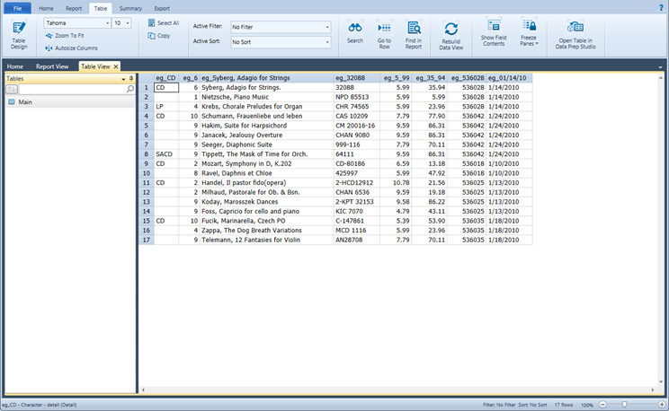

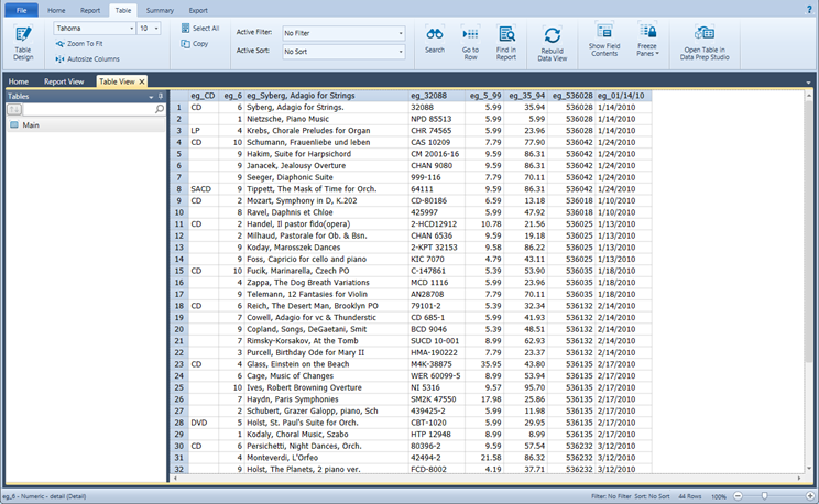

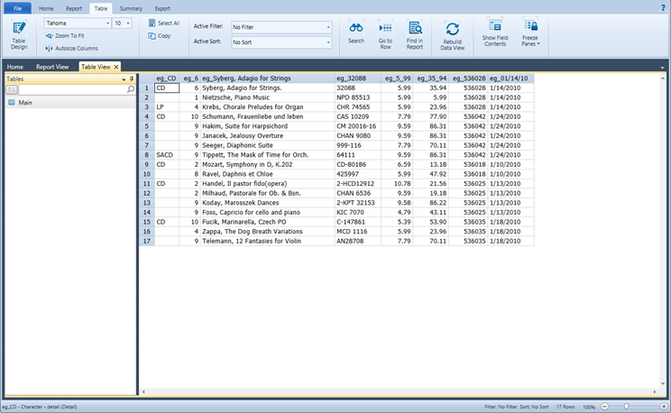

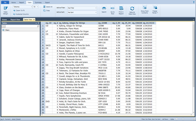

When trapping operations are performed on a report chunk, only the data from this chunk are displayed in Table view.
If you have multiple reports open, data from the specific chunk in all reports are returned.

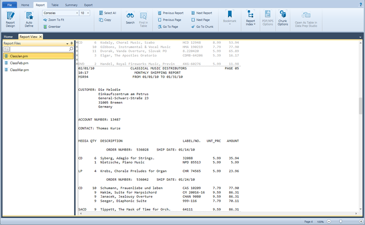

Once chunking options have been specified, you can change the chunk to display in Report View.
In the Report View ribbon, select Go to Chunk.
The Go to Chunk dialog displays.
Using the controls provided, specify a new chunk to load. Note that you cannot enter a number greater than the maximum number of chunks available.
Click OK when you are finished.
A new report chunk displays in Report View. If a model has been defined for this report, the data in Table View are also updated.
