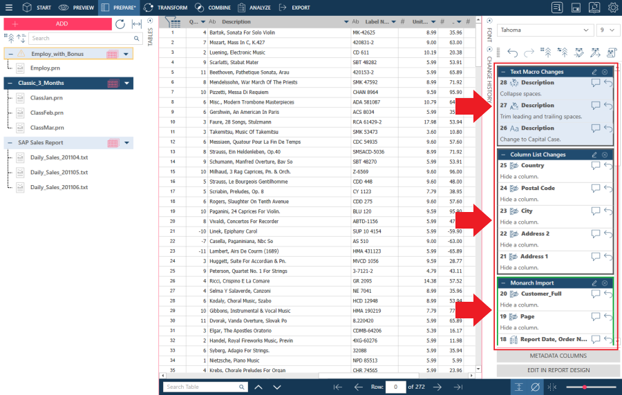

In addition to the change groups you've created, some changes in the Change History list may be grouped according to some criteria.
For example, changes associated with a model and report in a project created in a Monarch Classic and opened in Data Prep Studio will be grouped as "Monarch Import" changes. When a text macro consists of multiple changes (e.g., trim leading and trailing spaces + change to capital case), these changes will be grouped as "Text Macro" changes. As another example, all changes made from the Column List dialog will be grouped as "Column List Changes."

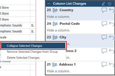

If, instead of collapsing an entire change group, you wish to collapse individual changes in the group, use CTRL+Click to select the changes to collapse and then right-click on your mouse. Click Collapse Change/Collapse Selected Changes from the options that display.
Your change group displays with the selected columns collapsed but all other columns left expanded.
When a change has been collapsed, hovering over this change displays a tooltip that describes the change.
To expand collapsed changes, select these changes (multiple collapsed changes can be selected using CTRL+Click), right-click on your mouse, and then click Expand Change/Expand Selected Changes.

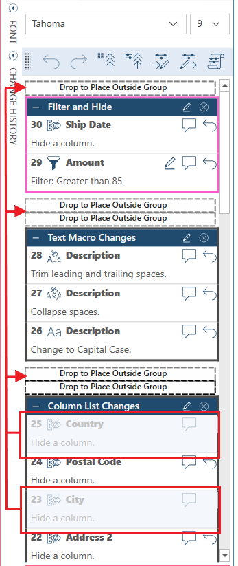

Adding/Removing Changes from a Change Group

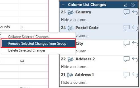

While change groups provide an easy means of applying the same set of changes to other tables or columns of the same type, you may find that one or more changes in a group are no longer necessary for your needs. In this case, you can remove the change(s) from the change group.
You can remove changes from a change group by selecting them (use CTRL+Click to select multiple changes if necessary), right-clicking on your mouse, and then selecting Remove Change/Remove Selected Changes from Group.
The changes you removed are moved outside of your change group.
Alternatively, you can select a change (or several changes) to remove from the group and drag and drop them anywhere else in the Change History list.
