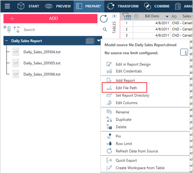

Add more reports by selecting the drop-down beside the main table and selecting Add Report.
Note that you must select a report that is compatible with the model you opened. Moreover, you cannot add the same report that is already being used in the model. In this case, the report will be skipped and will not be added to the model. The following warning popup will display:

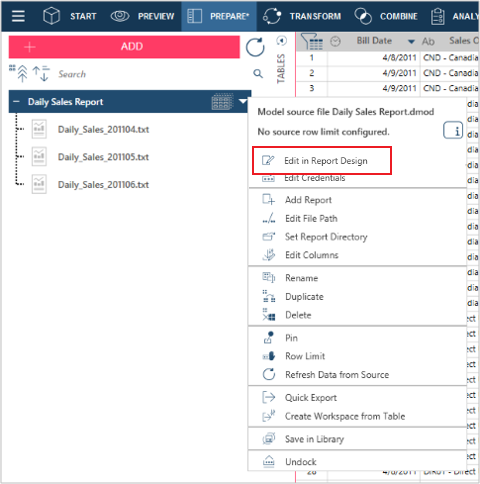

Edit a report's file path by selecting the drop-down beside the main table and selecting Edit File Path.
Modify the model associated with a Monarch Classic file by selecting Edit in Report Design.

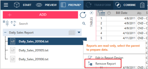

To delete a report, right-click on the report you want to delete and select Remove Report from the context menu:

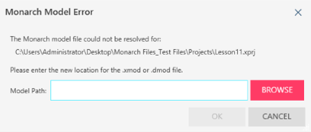

If you open a Project that uses a model that cannot be located, Monarch Data Prep Studio will display a dialog box telling you that the model cannot be found. Click the Browse button to look for the model and point the model to the correct location.
A similar dialog is produced if the report associated with a model cannot be found.

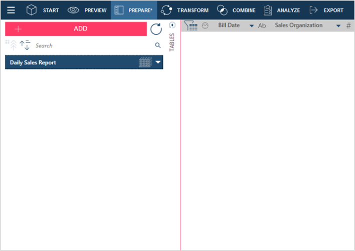

If you open a Monarch Classic model, the model is presented as a Table on the Prepare window. At this point, no data are displayed.

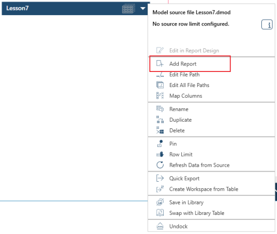

To view data, you must add reports compatible with the model. To do so, select the drop-down beside the main table and select Add Report:

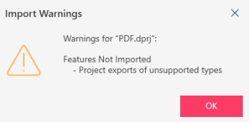

When a project/model containing elements not supported by Monarch Data Prep Studio is loaded into the application, a warning popup will display.
