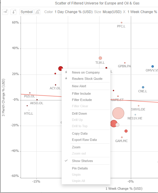

Actions are exposed to the user through the right-click context menu, with the Action icon to the left of the Action name.
