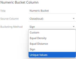

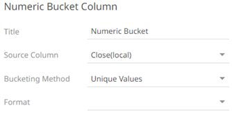

- Select Unique Values in the Bucketing Mode drop-down list box.
- Select the numeric Source Column and Format.

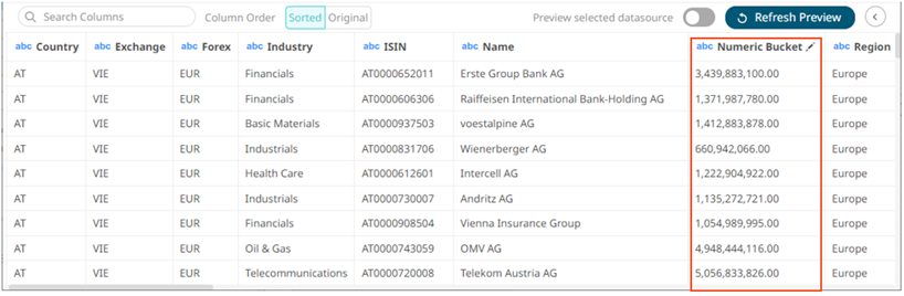

. The new numeric identify bucket column is added and displayed in the Data Preview.
These new identity columns can then be used as categories in the breakdown, and as categorical filters:
