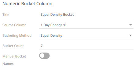

The numeric bucket instance is displayed on the Data Sources Settings with Numeric Bucket as the default title, also the Numeric Bucket Column pane displays.
You may opt to modify the numeric equal density bucket's Title.
- Select the numeric Source Column.
- Select Equal Density in the Bucketing Mode drop-down list box.

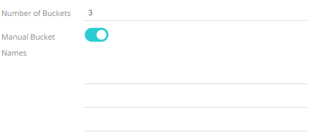

- Enter the Bucket Count. This value can be parameterized.
- Tap the Manual Bucket slider to turn it on.
The Names text box is enabled. For this example, 3 text boxes are available based on the specified Number of Buckets in step 5.
- Enter the bucket Names.

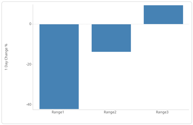

For this example, the minimum value of the Source Column (1 Day Change %) is -0.35 and the maximum value is 0.12. When there are three buckets the ranges will be:
- Range1: -0.11, -0.03
- Range2: -0.03, -0.01
- Range3: -0.01, 0.09
This can then be used in a visualizations breakdown to display data samples.
