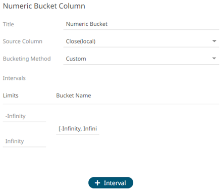

- Select the numeric Source Column.
- Select Custom in the Bucketing Mode drop-down list box.
The Limits and Bucket Name fields are displayed.

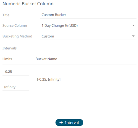

- Specify the customized limits of a bucket:
- Enter the –Infinity value in the Limits box with the minimum limit value of the bucket.
This value is displayed in the Bucket Name box replacing the –Infinity value.
- Enter the Infinity value in the Limits box with the maximum limit value of the bucket.
This value is displayed in the Bucket Name box replacing the Infinity value.
The range of the limits is now displayed in the Bucket Name box.
- You can opt to modify the Bucket Name.

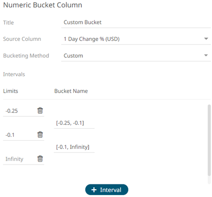

- To add more buckets, click
Another bucket definition box is displayed.
Note that the preceding Infinity bucket value is now the minimum limit value of the new bucket.

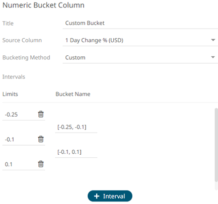

- Replace the Infinity value in the Limits box with the maximum limit value of the new bucket.
